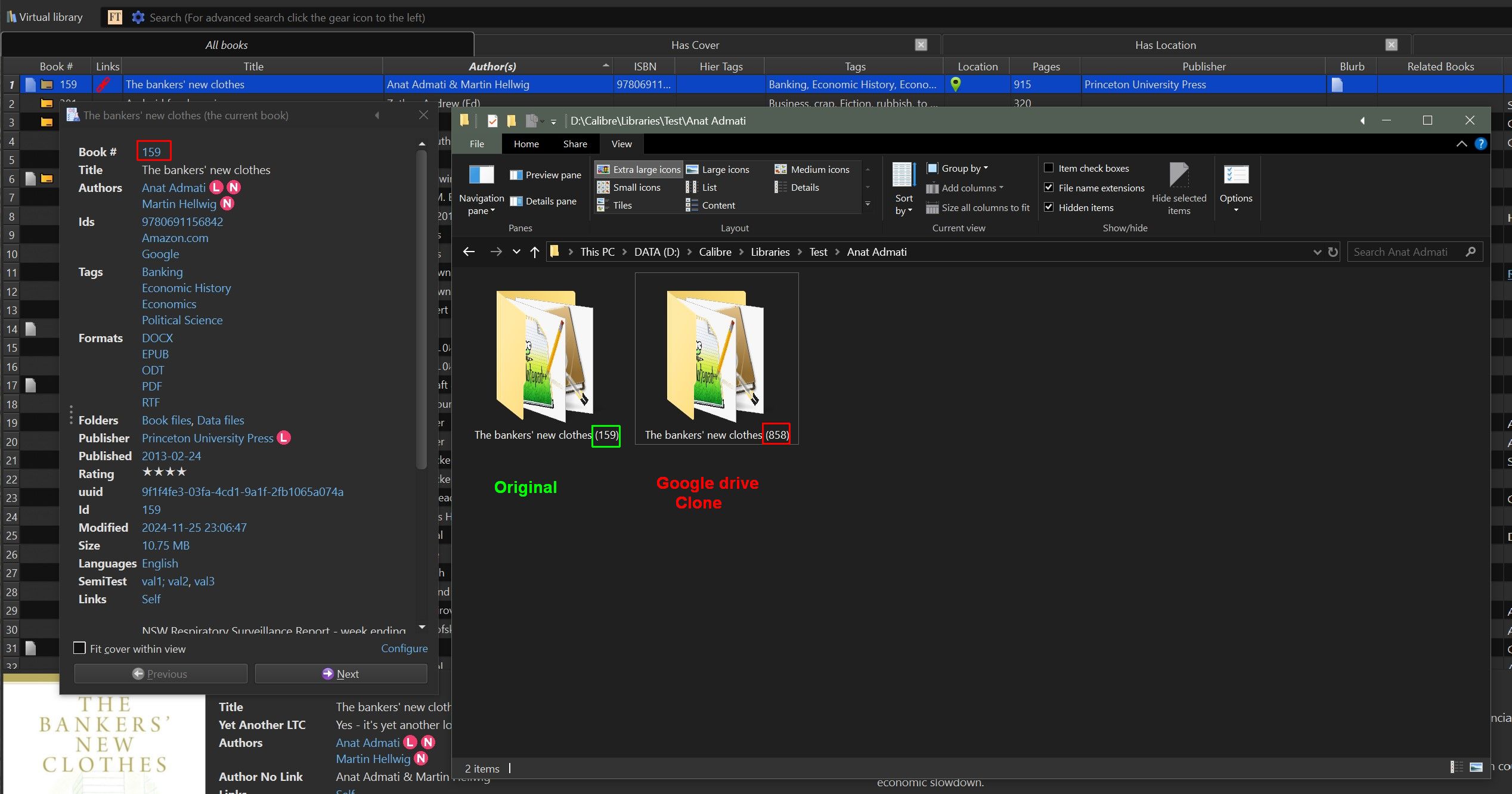

If extra book folders have different suffixes like so:
Name:	Screenshot 2024-12-03 115650.jpg
Then it's London to Brick they were created by Google Drive.
Attachment 212331
Umm, what do the letters in your screenshot mean and how did you create them?
I mean this:
Name:	MWSnap 2024-12-02, 22_22_27.png

I failed iconography, so its L for Link, N for Note. They are white on red because that works in dark or light. I looked for free "Circle L" and "Circle M" pngs.
