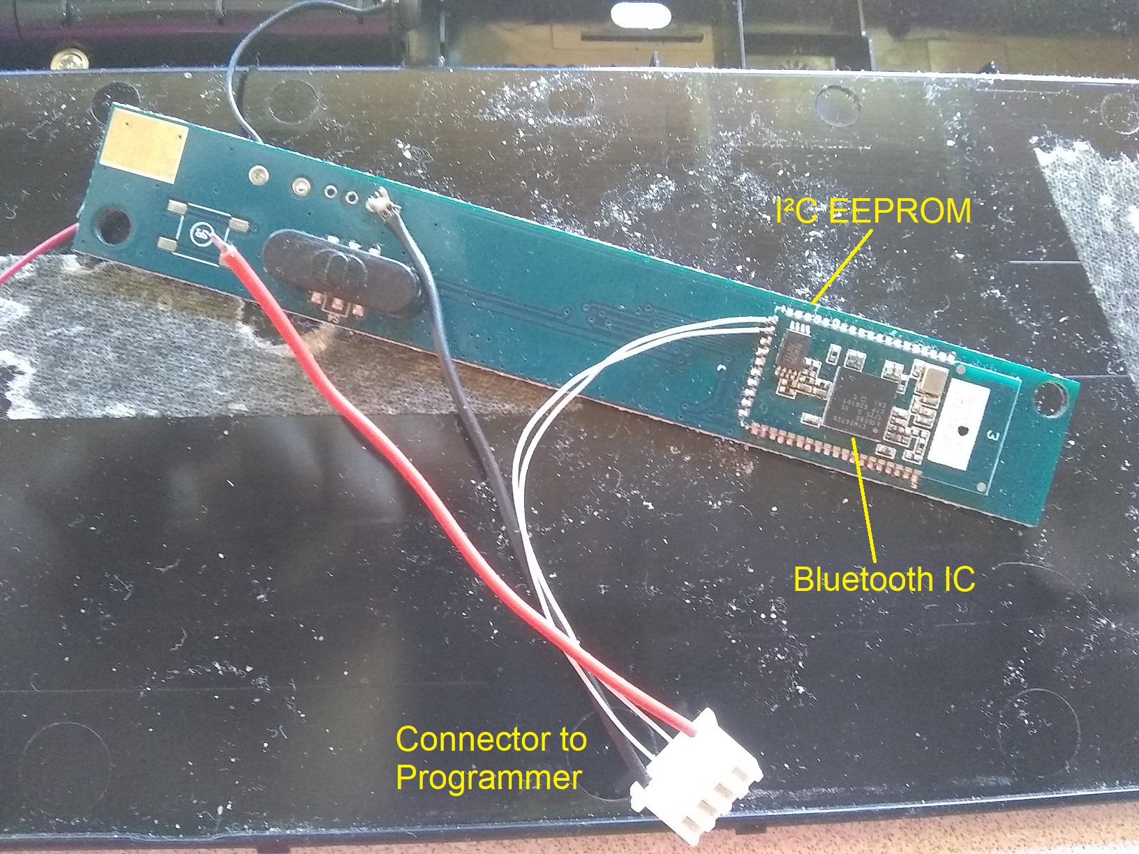

If it does have an EPROM you can program it with a 3.3V I²C interface.
But you have to read the memory, then figure out what to do, then write it.
You may buy the exact thing tomorrow and they got rid of the EPROM and just use masked ROM.
That's how I got a dozen clickers that were useless!
It has to have an IC that looks like this:
It's from an Anker BT Qwerty keyboard.
I didn't change it much, just changed the BT name from something like KM1234 to "English" to differentiate it from my Russian keyboard.

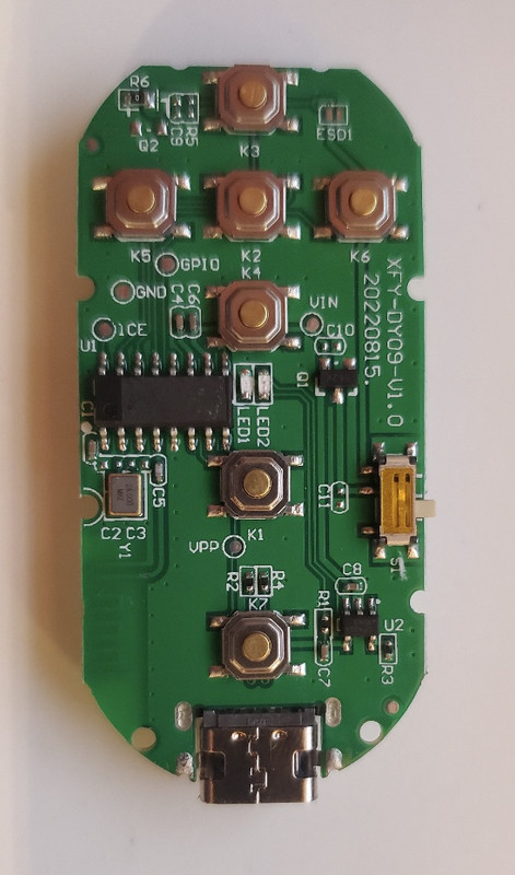

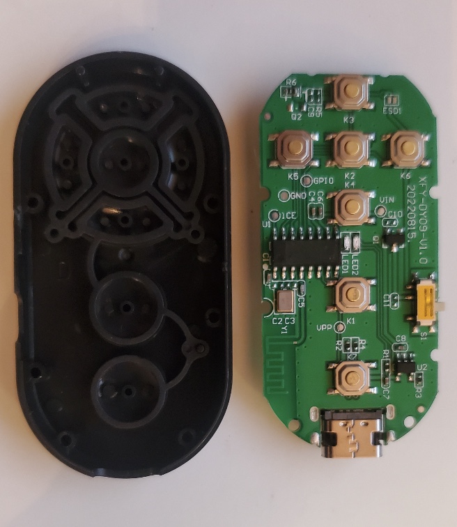

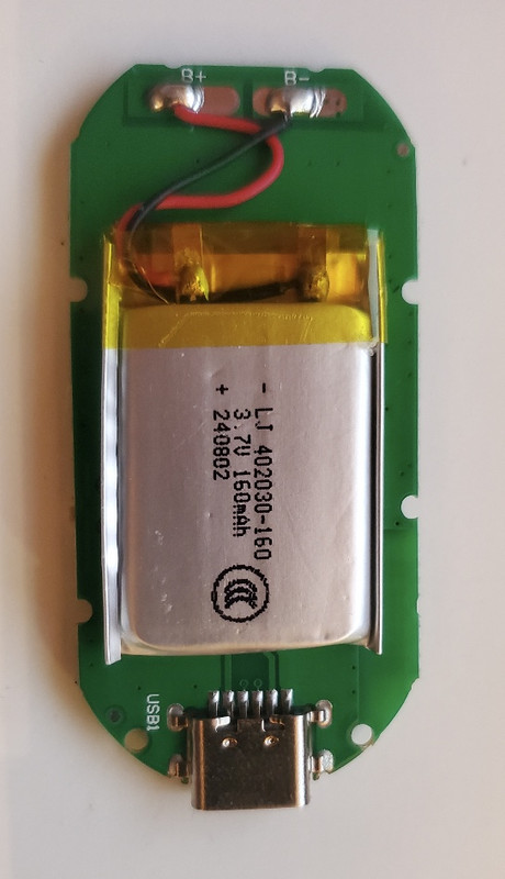

@Renate thanks for indulging me. I opened the device (images below.) I don't know if there's an EPROM. Not even sure if whatever is inside is flashable. It does look neat.
Also figured out what the device is really doing.
Normal mode: the directional buttons act as a swipe. I know Kobo supports swipes, so wondering if it's possible to map the swipe actions to page turns using kobo-btpt.
Configure mode: the directional buttons slowly moves the pointer. Once the position is set, the camera button works like a click. This behavior is not that useful for my purpose but good for mobile apps and such.
https://i.postimg.cc/kDPVB7qC/Screen...7-32-34-PM.jpg
https://i.postimg.cc/XqCGjrMx/Screen...7-32-44-PM.jpg
https://i.postimg.cc/XJhB6wPp/Screen...7-32-52-PM.jpg

No, that device is programmable (not masked) and doesn't use an EPROM.
It's a nicely built and that it's rechargeable with USB Type C is nice.
So, here's the thing. It uses 1 wire programming ("ICE", in-circuit emulator).
I've got an ATMEL ICE here that can do SWD (single wire debug).
You might be able to play around and read the memory out or they might have locked it.
You need a separate, higher voltage power supply at Vpp to program it, but that comes later.
They sandblast the chip so that you can't see what it is.
So it's a mixed bag. The entire code is there but you may not be able to read it.
With an EPROM you can't read the main code (from the masked ROM) but you can R/W the options in the EPROM.
