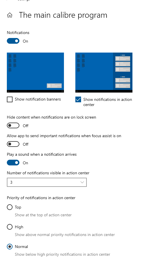

I've set it this way on Win 10:
Name:	MWSnap 2024-11-25, 16_43_45.png
As I have the Calibre setting in Look & Feel disabled, I see only the taskbar flashing upon a task completion, no notification banners at all.
Attachment 212203
I just turned it off as I don't need or want to be notified.

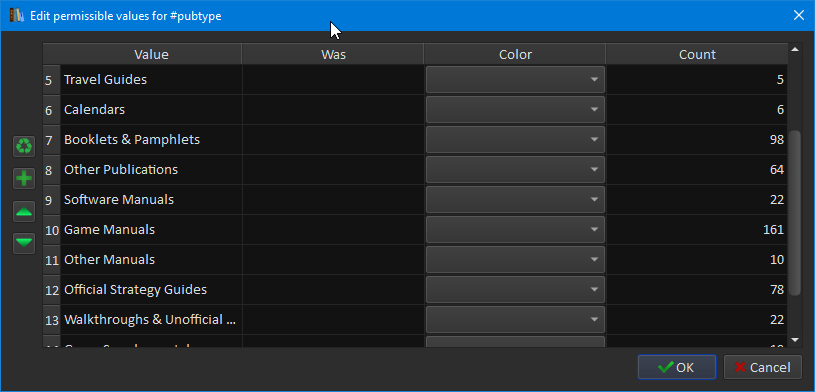

Like to see this
Name:	2024-12-13 05_50_21-Edit permissible values for #pubtype.png
Are we now going to monthly full-releases instead of biweekly?
