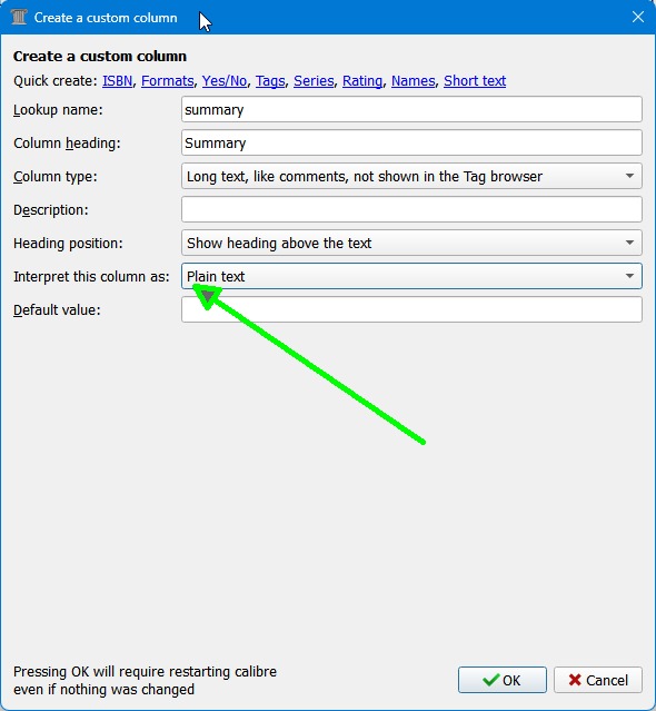

Originally Posted by nevermiffed View Post
I just finished getting all my fanfic onto Calibre, and I am trying to get the summary onto the cover of the books. I have the generate cover plugin and while I can have the summary on the cover, it has a lot of HTML with it. How can I make it, well, not have that?
I was trying to make a custom column for summary/comments that would edit those out, but I have no clue what I'm doing here.
I was mostly using these posts as a guide
https://www.mobileread.com/forums/sh...d.php?t=331027
https://www.mobileread.com/forums/sh....php?p=4143924
If you don't want HTML in the summary text then set it up as a plain text column, as shown in this screen capture. If you change the "Interpret this column as" for an existing column you must remove the HTML from any existing value.
That said, I agree that when using a Kobo it is much better to put the blurb into its book details. This requires that the blurb be in the Comments column.
