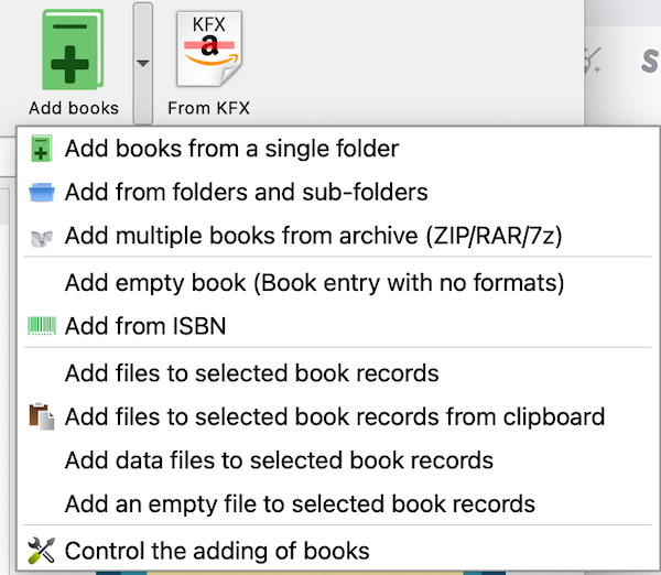

Originally Posted by maddz View Post
Now that's interesting, a azw8 novel imports from K4Mac as a KFX file if you use import as archive, but a graphic novel doesn't. If you import as All files it imports as an archive...
Selecting Archive in the import wizard doesn't 'see' the awz8 archive file as an archive even though the file type is a Stuffit Expander file. Weird. I wonder if it's a function of size.
I am not understanding how you are importing and what it means to "import as archive". Usually, I just drag-and-drop the azw8 file into the calibre window.
When I tried the Add Books button and clicked "Add multiple books from archive", the azw8 is not selectable, presumably because it's a single file and not an archive.
How are you "importing as archive"?
