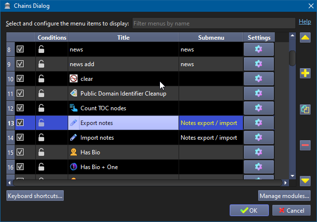

Not a big issue but I found that some icons in the Chains dialogue can't be themed:
  • arrow-up
  • arrow-down
  • edit-copy
  • minus
  • plus
I was able to override them using the resources/images folder. However, from looking at 'def get_icon_6_2_plus' in common_utils.py, it looks to me that the icon theme should be prioritized, though it isn't currently being acknowledged, for some reason.
I wanted mainly to theme the 'plus' and 'edit-copy' icons because they look to me a bit faint in dark mode.
The other icons, notably the ones called by Qpushbutton, will change in accordance to the theme images.
I'm running 7.20.101 with the latest plugin version 1.20.7.

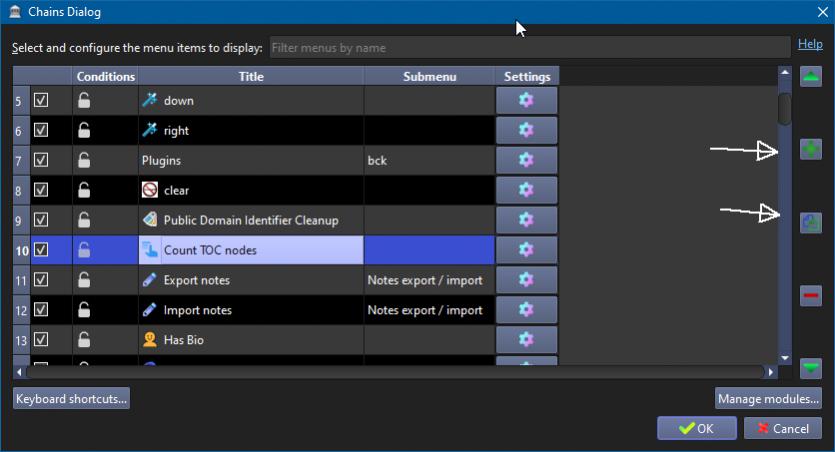

Try the version attached below and see whether it works. This happened after calibre was updated to version 6 with some changes to icon management. I did not fully port the whole code at the time. The changes affect the following parts of the plugin:
That is a matter of opinion. I personally think the priority should be to custom icons.

Wheee, it works! I did a few tests in each area and all seems fine:

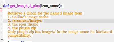

Actually what I wanted to mean was that, according to the comments in the code, the icon theme images were expected to be used in preference to the resources folder.
I too think that the resources folder must have higher priority than the themes. And upon a quick test using distinct icons for the main plugin icon in the theme and in resources folder, all is working fine as well: the image that shows in Calibre main toolbar is the one in resources.
edit to add - now that I looked again at the comments in the code, it's clear that I got things mixed up:
