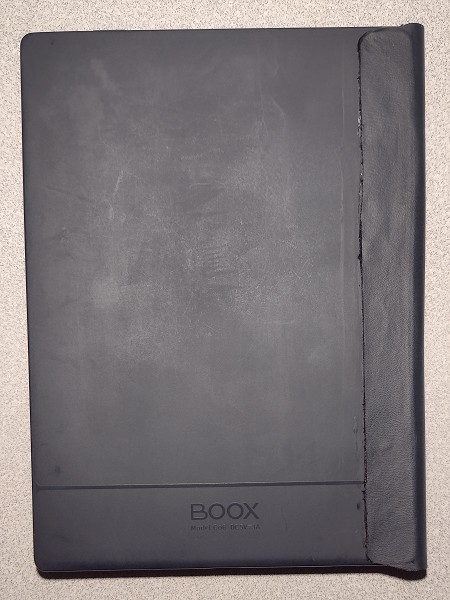

It's not as neat as I would have liked, but...
The next time I'd do it a bit differently with the gluing as it's hard to get the alignment perfect. I'd put the unmodified cover down, mate the reader with the cover open. Using a fine point Sharpie (or maybe a pencil) draw a reference line on the inside of the cover snug against the reader. Then trim the back cover to 1/2" of the "thick part", You have to carefully extract 1/2" of the plexiglass inner either as a part of the whole cover or as a stub if you just sawed through the cover. Then you need to glue the delaminated part of the "leather" stub together. When dry and cleaned up then lay the cover down again, apply glue to the stub and align the reader on the stub by the line with the cover open. You can clean any excess glue off the hinge area with IPA while the glue is still not completely set.
This is the Go6. I tapered the back stub and rounded the corners a bit. It's better than the Poke5 where I kept it square.
Renate is online now   Reply With Quote

Still looks cool and simple enough to do!
Does it stick to the back when you open it 180 deg?
Yes, it sticks around backwards just as securely as the unmodified version as the four magnets on the front cover stick to either the front or the back of the internal four magnets. It's so strong I can sandwich some 3 mm (1/8") plywood between them. That's how my stand holder works in https://www.mobileread.com/forums/sh...61&postcount=7
