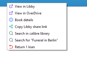

Originally Posted by foosion View Post
Perhaps have a button to open libbyapp.com, if possible to the download page for the relevant book, just to make things a bit easier.
Is this any easier than right-clicking on the book and selecting either of the top two options?
Yes. Right-clicking on Libby leads me to a page that lets me read the book on my computer ("open book"), but not download the acsm. Overdrive leads me to a page that allows me to borrow the book (perhaps because I have multiple cards and it defaults to one that may not have been the one I borrowed from).
At the bottom of the libby page there's a "read with ..." and underlined epub, but clicking on epub just gives me a popup saying download a file that can be read, rather than downloading the file.
I have the feeling I'm missing something.
Plus, if possible, the "monitor folder for new acsm and if so download to calibre" function.
EDIT: The useful links, from which I can download the acsm file, are in the form https://libbyapp.com/shelf/loans/123...012345/fulfill
