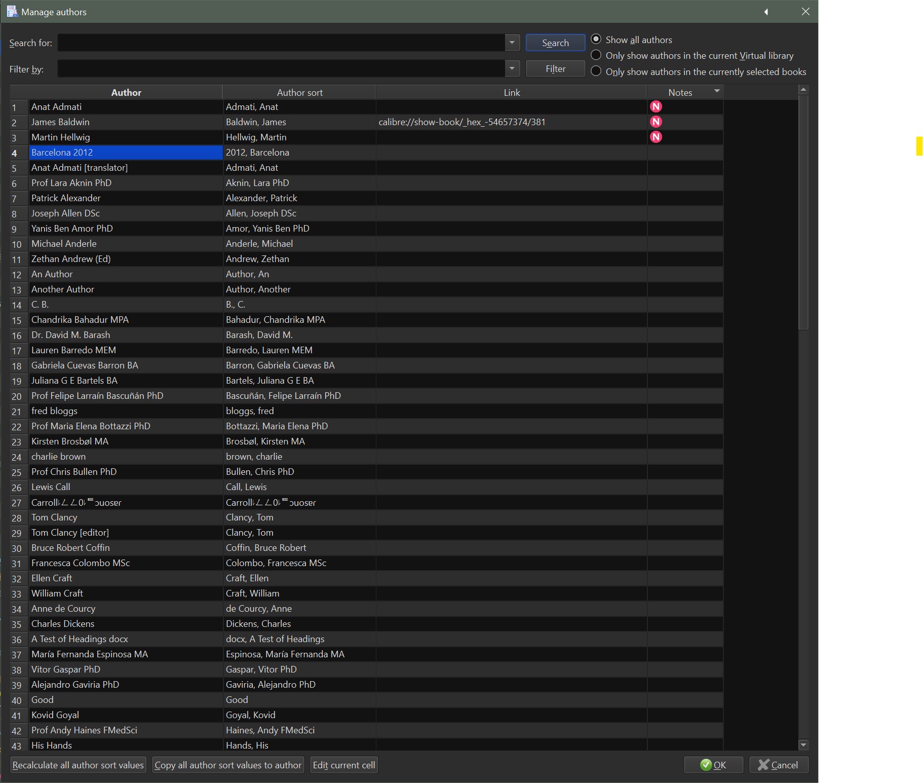

Posts: 22,868
Karma: 34252730
Originally Posted by thiago.eec View Post
I just want a way to quickly filter the book list for authors that do not have a note yet, so from time to time I can add the notes.
Why not look at the Author list from time to time via Manage Categories, it'll be a lot shorter and you can sort the list on the Note column to force all the sans-Note authors to the top of the list.
I have the shortcut Ctrl+Shift+C set to Manage categories, and the 'white N in a red circle' is my <config>/resources/images/note.png image.
Attachment 211717
If I could select multiple authors, this would do. But you can select only one at a time.
Also, when I click in the Notes header, I get this error:
calibre, version 7.20.100
ERRO: Exceção sem tratamento: <b>IndexError</b>:tuple index out of range
calibre 7.20.100 embedded-python: True
Windows-10-10.0.22631-SP0 Windows ('64bit', 'WindowsPE')
('Windows', '10', '10.0.22631')
Python 3.11.5
Windows: ('10', '10.0.22631', 'SP0', 'Multiprocessor Free')
Interface language: pt_BR
EXE path: C:\Program Files\Calibre2\calibre.exe
Successfully initialized third party plugins: Gather KFX-ZIP (from KFX Input) (2, 16, 0) && DeDRM (10, 0, 9) && Package KFX (from KFX Input) (2, 16, 0) && ACE (1, 1, 6) && Access Aide (0, 1, 15) && Annotations (1, 17, 13) && Calibre Power Search Plugin (2, 2, 0) && Check Books (0, 2, 0) && Comments Cleaner (1, 15, 0) && Count Pages (1, 13, 6) && Diaps Editing Toolbag (0, 5, 0) && Ebook Translator (2, 3, 5) && Editor Chains (1, 1, 9) && EpubCheck (0, 2, 5) && EpubMerge (3, 2, 0) && EpubSplit (3, 9, 0) && Favourites Menu (1, 3, 1) && Find Duplicates (1, 10, 9) && GR Author Notes (1, 1, 1) && Goodreads (1, 8, 2) && Goodreads Sync (1, 16, 9) && KFX metadata reader (from KFX Input) (2, 16, 0) && From KFX (2, 16, 0) && KFX Input (2, 16, 0) && Set KFX metadata (from KFX Output) (2, 11, 0) && KFX Output (2, 11, 0) && KindleUnpack - The Plugin (0, 83, 1) && Open With (1, 8, 3) && Quality Check (1, 13, 15) && Reading Goal (1, 7, 4) && ScrambleEbook (0, 6, 0) && Skoob Books (1, 5, 6) && Skoob Sync (0, 5, 7) && Sum Column (0, 3, 1) && TextDiff (1, 2, 4) && ePub Extended Metadata {Writer} (0, 11, 4) && ePub Extended Metadata {Reader} (0, 11, 4) && ePub Extended Metadata (0, 11, 4)
File "calibre\gui2\dialogs\edit_authors_dialog.py", line 558, in do_sort
IndexError: tuple index out of range
This is a regression introduced by adding the counts column to Manage Authors. I submitted a fix.

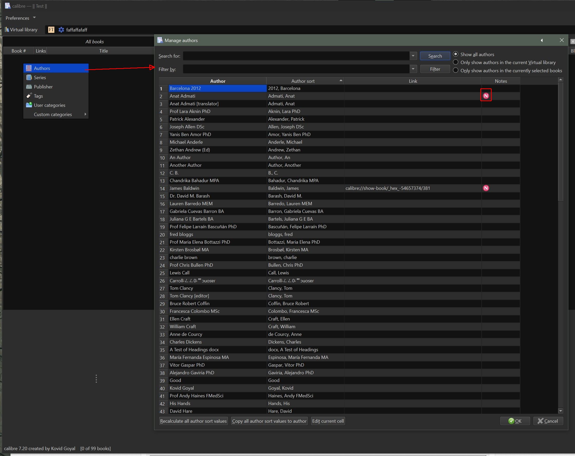

FTR only.
The only reason I can imagine one would want to select multiple authors in Manage authors would be to attach the same note (or link) to multiple authors, but a subsequent change or delete to the note (or link) in one author would not ripple through to other authors.

Works for me, viz:
Name:	Screenshot 2024-10-29 082615.jpg
