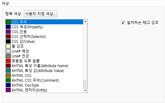

Old 10-26-2024, 12:05 PM   #3
chocoberry317
chocoberry317 began at the beginning.
Posts: 7
Join Date: Oct 2024
1. Yes, that option is active.
2. No, the problem does not appear when entering latin chars.
chocoberry317 is offline   Reply With Quote
Old 10-26-2024, 12:44 PM   #4
KevinH
Sigil Developer
Posts: 8,797
Karma: 6000000
Device: many
I see the same grey colour in both. Exactly what is wrong in your first image if it is not the grey?
Please try turning off the Sigil Preferences to highlight matching tag pairs. Does the issue still happen?
What font are you using? Are you sure it is a real monospaced font?
Old 10-26-2024, 08:50 PM   #5
chocoberry317
Posts: 7
Join Date: Oct 2024
The monospaced font I use is Courier New.
Also, I turned off that option, but the problem still appears.
When I type Korean chars, they are not displayed in real time and are grayed out, making it inconvenient to check if I have entered the correct char.
But, there is no problem when entering Latin chars.
Would you like to see the video I uploaded? You can check the problem I mentioned.
