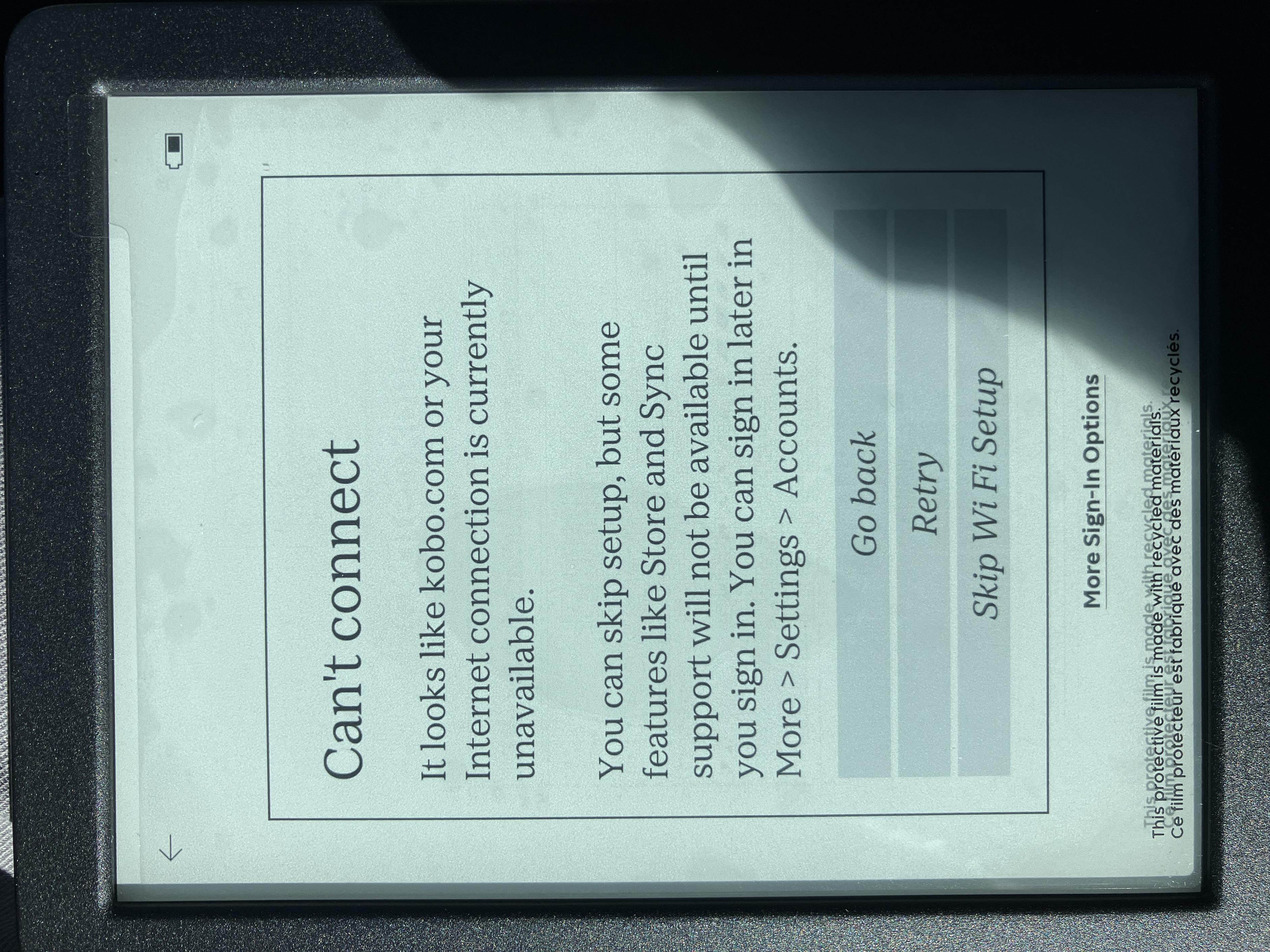

I was able to duplicate the skip WiFi setup screen on the second Clara.
I selected language, connected to WiFi, let it update, and then at the activation screen, I selected activate using ereader at the bottom. After I selected that, I turned off WiFi. It then gave me the attached screen.
gustophersmob is offline   Reply With Quote
Hmm, I guess image tags don’t work and I can’t edit.
Let’s try this:
