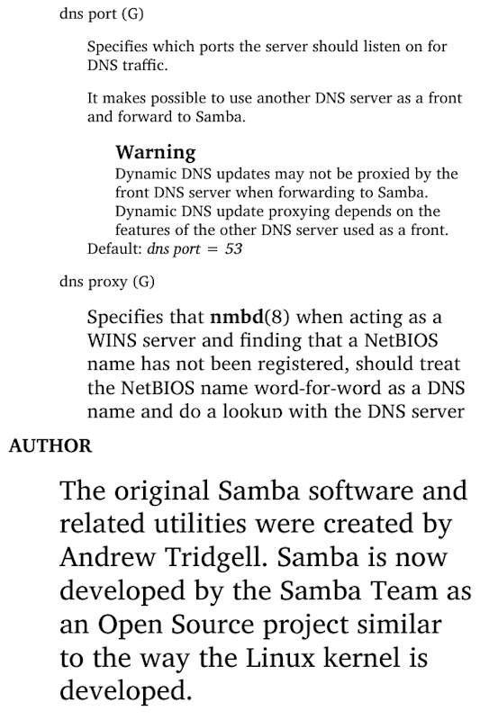

"c:\Program Files\Calibre2\ebook-convert.exe" smb.conf.html smb.conf.epub --authors "Samba" --title "smb.conf"
For some reason, Calibre increase the font size halfway through and it only increases till the end (see attachment).
Edit:
pandoc.exe --metadata author="Samba" --metadata title="smb.conf" -f html -t epub -o "smb.conf.epub" "smb.conf.html"
Perfect! Thanks all.
