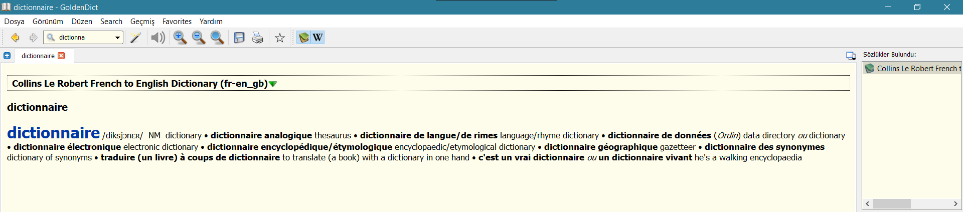

Originally Posted by Thorns View Post
Have sent you a PM with the file if you wouldn't mind looking at it? Just the MOBI file. I wasn't sure if allowed to post here publicly. Would really appreciate any advice either way
Alright, from what I gather you first converted the AZW3 to MOBI via calibre which I suppose stripped all dictionary related tags. Instead, you should have unpacked the azw3 directly via KindleUnpack plugin. Then, the script will be able to parse all entries. Here is the preview of resulting stardict file on GoldenDict:
Name:	Ekran görüntüsü 2024-10-19 104145.png

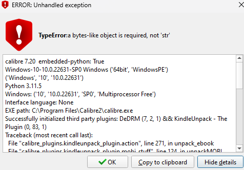

So when trying the exact same steps I get the following error with the plugin, which is the same error I get when trying to unpack the original azw file directly. How strange!
Is there any way you can share the output?

OK - I got it to work! I had to use another version of the calibre plugin to get the unloading to work properly. Then I ran the script and copied the contents directly to Koreader and it seems to work perfectly. I attached the version I used incase anyone else needs it.

Yeah, I remember modifying my local copy of the plugin to bypass that error. Glad it worked out for you.
