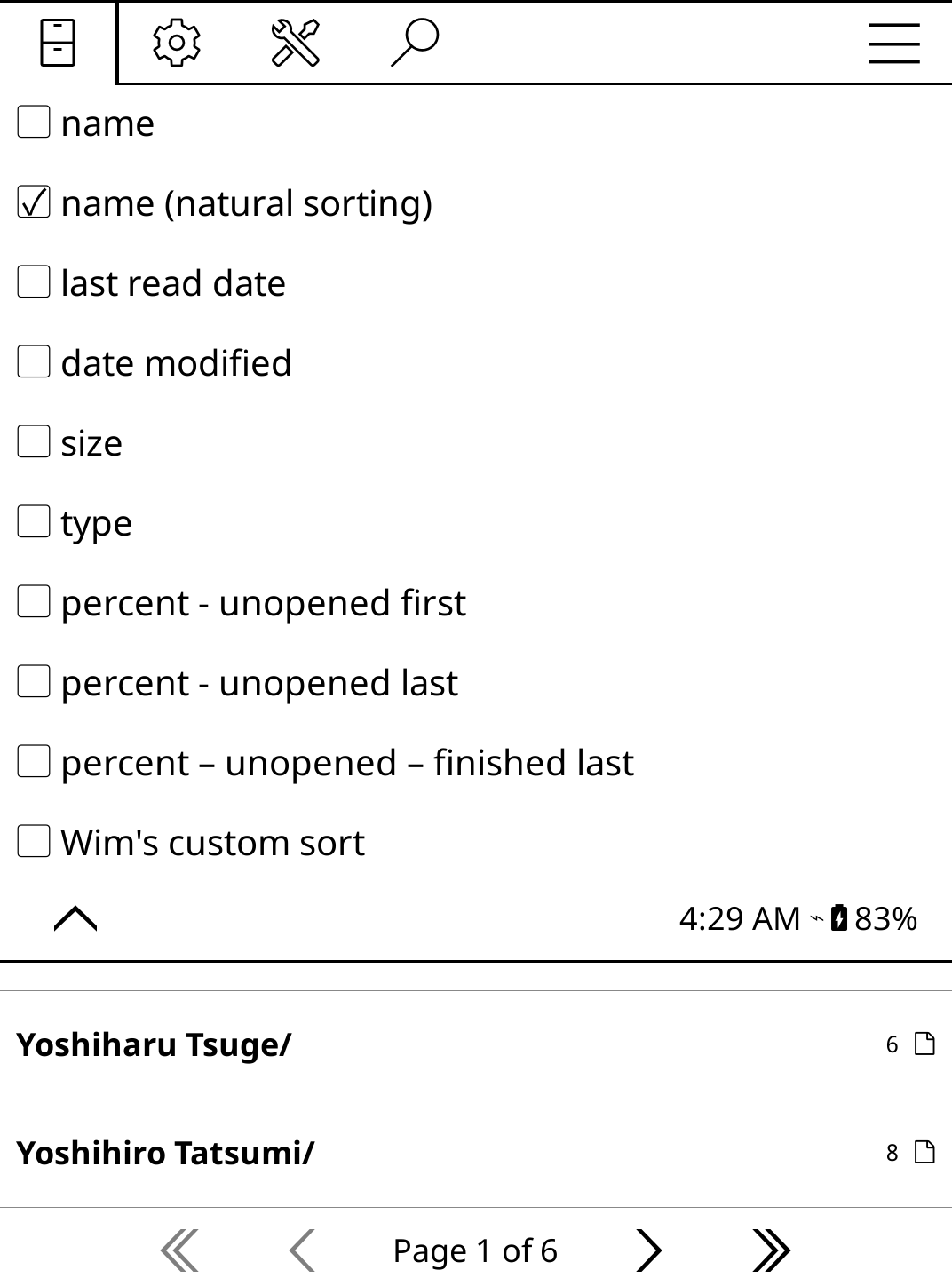

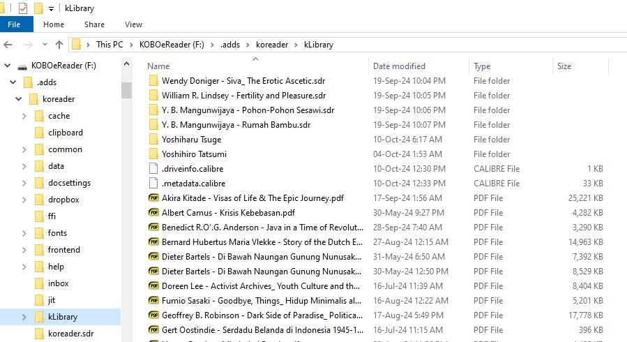

I use Calibre to organize and send books to KOReader wirelessly with a saved template in SmartDevice plugins to arrange them in the KOReader folder
You can set how the book is sorted on KOReader as shown in the attached image.
IMHO, it is easier to organize books on KOReader using Calibre than copy-paste the book to the KOReader folder.
