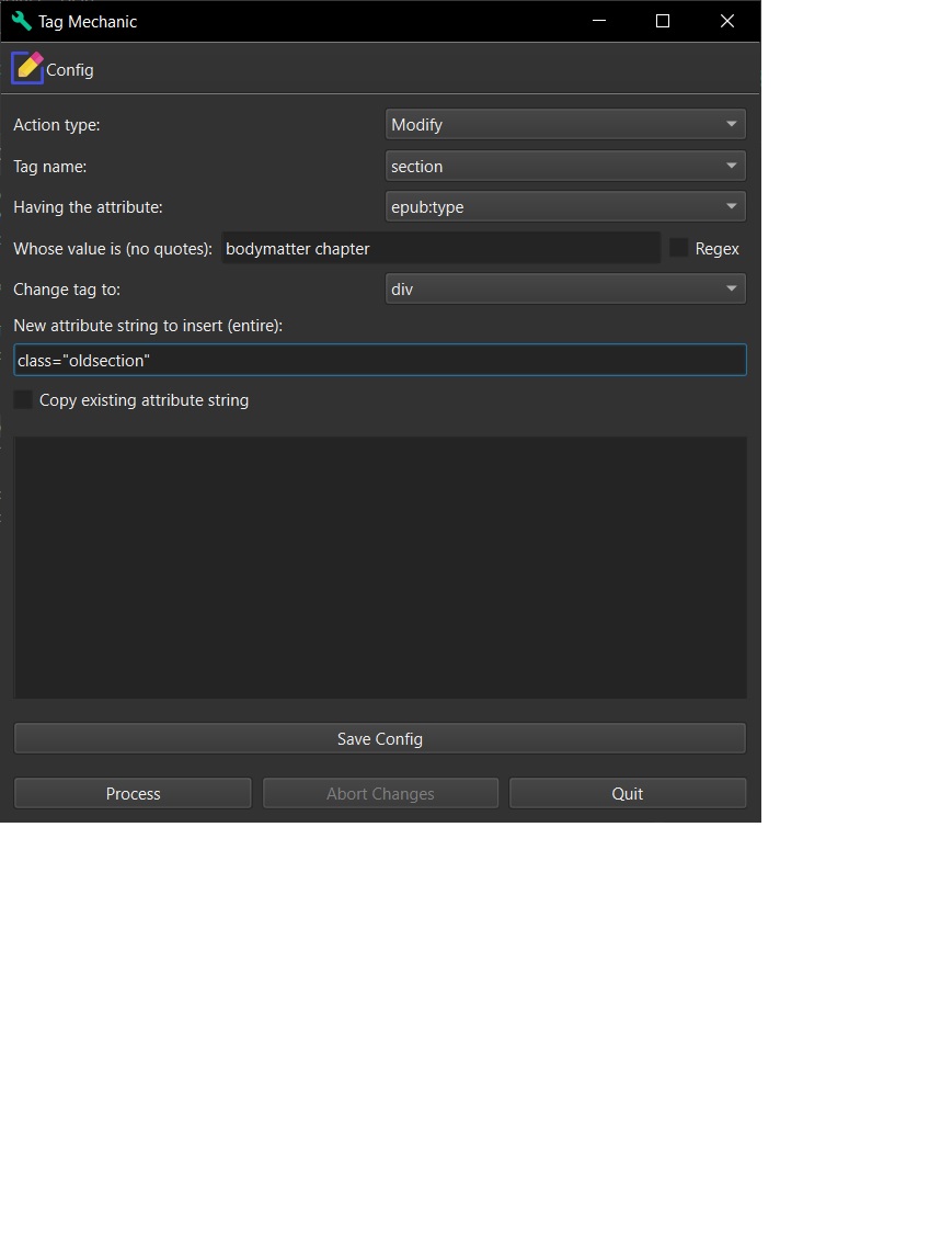

BTW, if I wanted to eliminate all <section epub:type="bodymatter chapter"> or the like, how would I set the plugin? I could use regex to add a, for example, id tag, then match the id with the plugin, but that would seem to defeat the purpose.
There'd be no need to add an id tag to then match with the plugin. What would be the point of that? You could just match the attribute string of the section tag with the plugin (one attribute and literal value pair, or some regex subset of the attribute value).
You may need to first add "epub:type" as one of the attributes to search on in the plugin's config. But that's a permanent change, not a one-time thing.

Aha. I hadn't looked at the customization carefully enough to realize you can add a type. I'm using the Calibre editor plugin BTW.

Originally Posted by foosion View Post
Aha. I didn't realize you could add attributes in the config. The reason for adding id was that it was already on the list.
Gotcha. Yes, you can add custom attributes... as well as adding more tag choices to change things to. You can even add some new tags to search for, but you'll have to edit the preferences manually to do that. My original goal was only including nestable stuff, because unnestable stuff was fairly easy to change with regex alone, but people kept wanting more tags added.

I figured it out. Click customize, then at the bottom add to the list of html attributes to search for.
