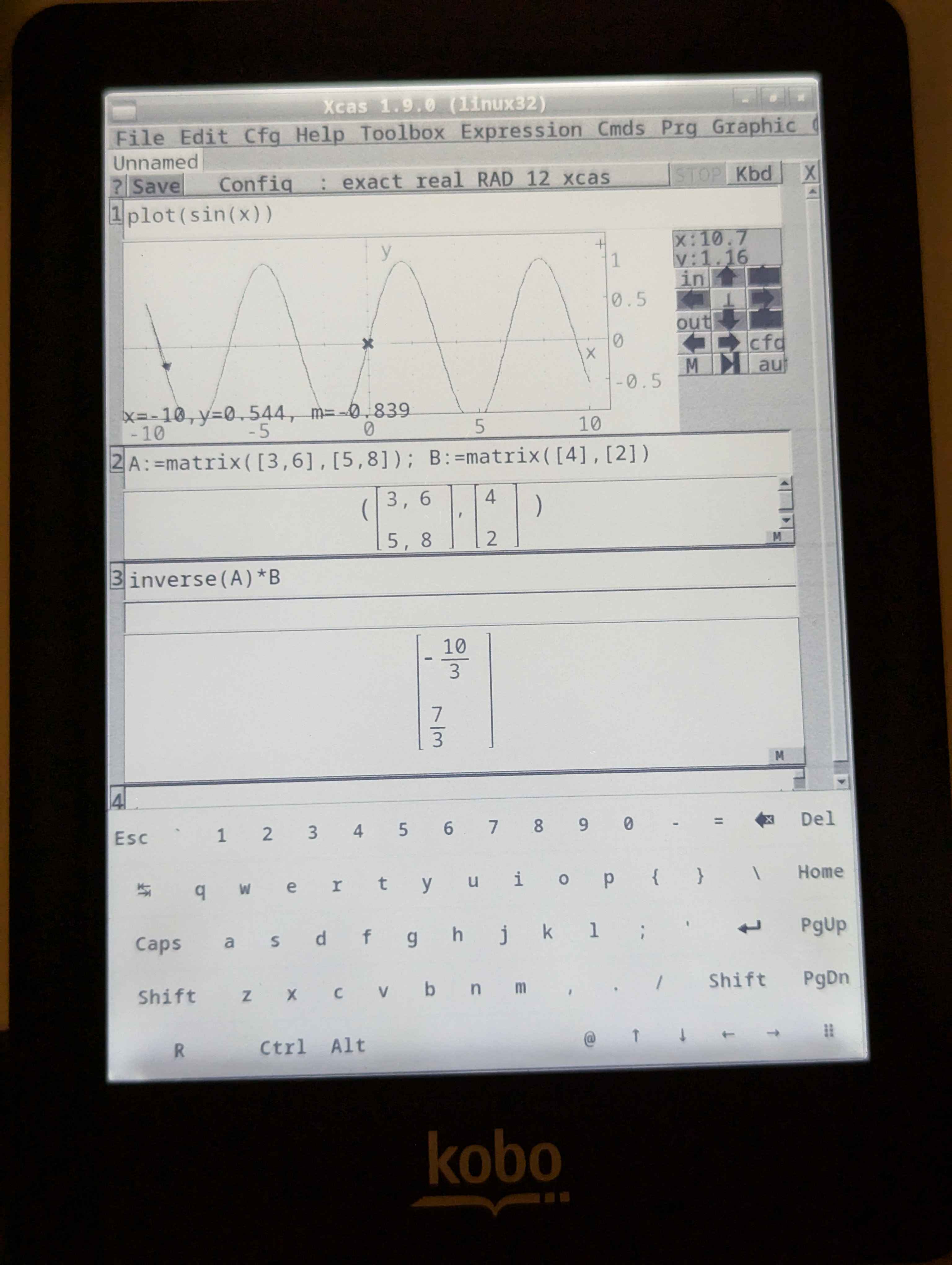

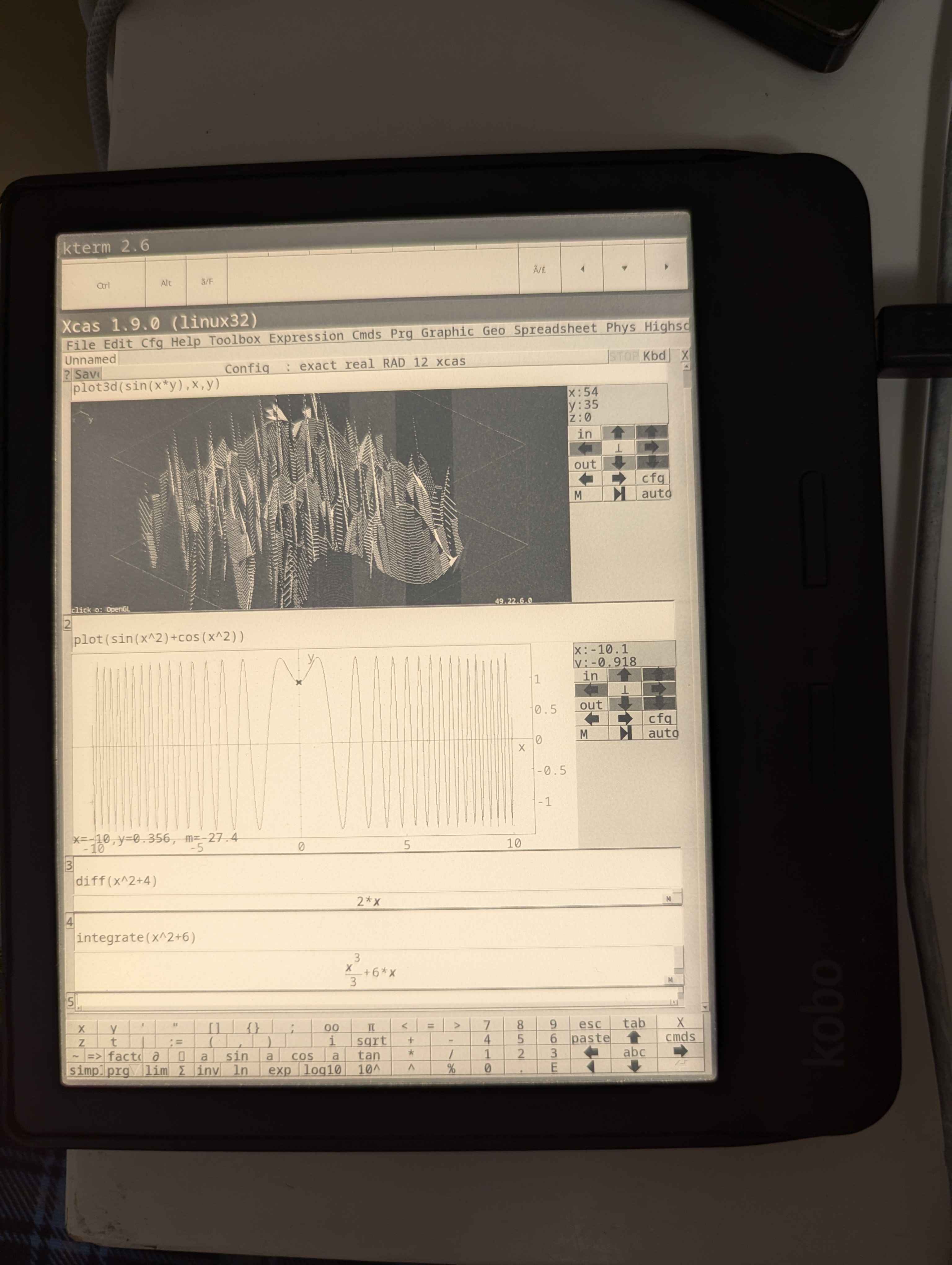

Smile Xcas ported to Kobo!
I successfully compiled Xcas for KoBox on Quill OS; if enough people are interested, I will consider making it a bundle available for download. Even OpenGL works!
Bit of an oddity to see a CAS on an eReader
Anyways, feel free to let me know if you are interested in running it on yours as well...
ID:	210190   Click image for larger version
