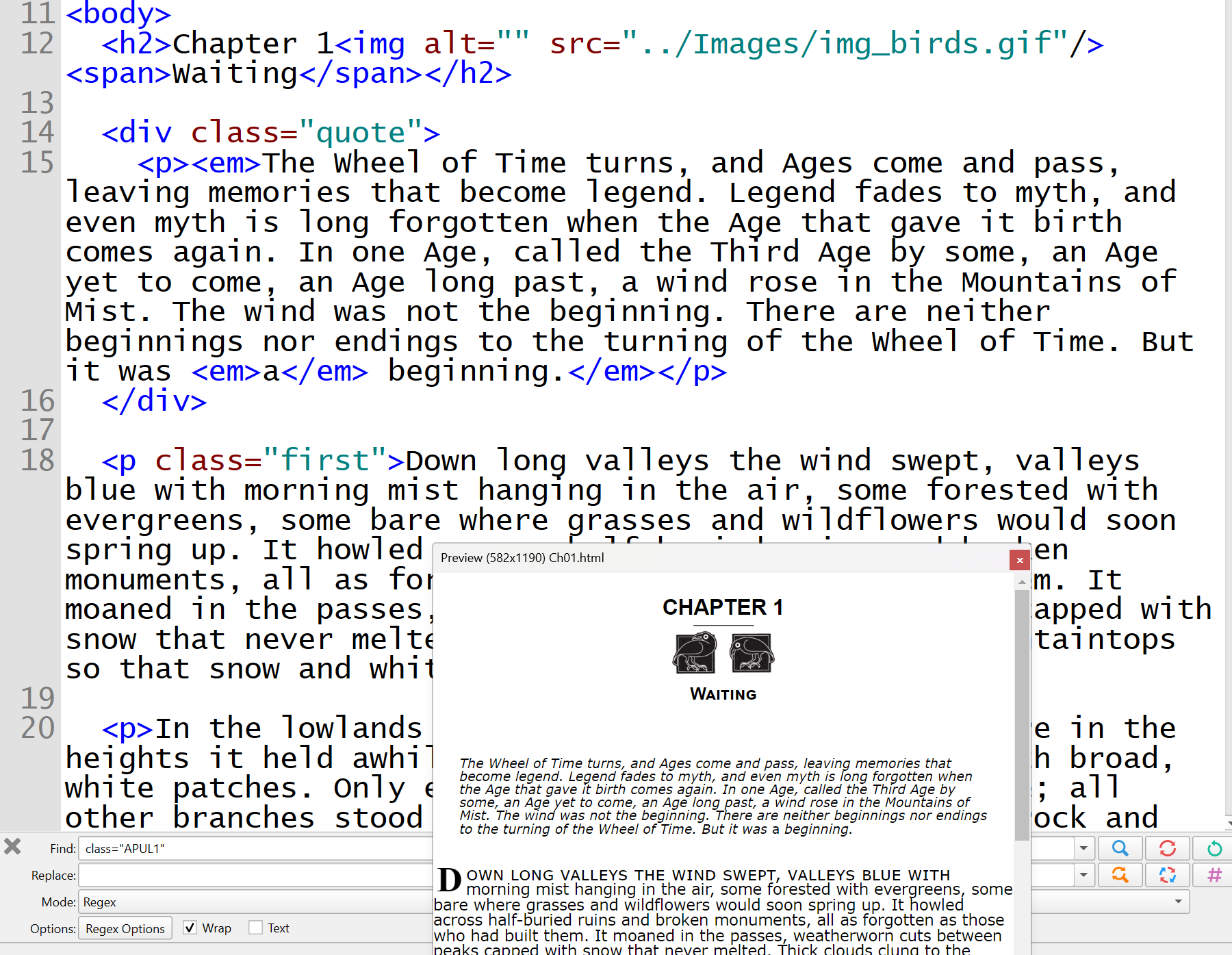

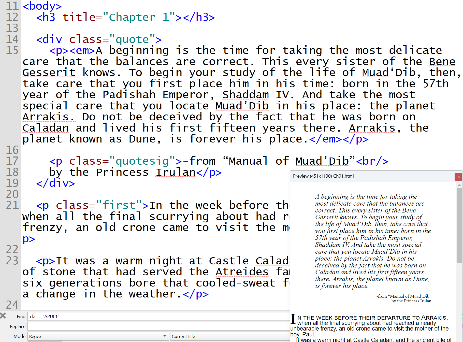

Old 10-04-2024, 10:35 AM   #40
Turtle91
A Hairy Wizard
Turtle91's Avatar
Posts: 3,490
Karma: 21099999
Join Date: Dec 2012
Personally, I prefer not to use first. I don't like dropcaps or large first letter or smallcaps, etc. I just like normal text unless there's a reason for a style.
You certainly can do it that way, and that is what I was referring to when I mentioned you can be as creative or plain/vanilla as you want.
I don't need a class as I can style h2 + p as needed.
Yes, you can do it this way as well, but it makes the css a bit more unruly. Which do you think is cleaner?
h2 + p  {}
h2 + p::first-letter {}
h2 + p::first-line {}
-OR-
p.first  {}
p.first::first-letter {}
p.first::first-line {}
Also, you need to consider that there are a lot of books out there that have something inserted between the chapter head and the first paragraph, so a simple h2 + p doesn't work. Whereas, if you get in the habit of semantically labeling the first paragraph, your styling of choice will be appropriately rendered regardless of any intervening elements. Here are a couple of examples:
Name:	Screenshot 2024-10-04 101603.png
Name:	Screenshot 2024-10-04 101239.png
Name:	Screenshot 2024-10-04 101102.png
Quiz Time!
Can you name the Book/Author from the images above? (no cheating)
image 1: The Long Earth by Terry Pratchett and Stephen Baxter
image 2: The Dragon Reborn by Robert Jordan
image 3: Dune by Frank Herbert
Turtle91 is online now   Reply With Quote

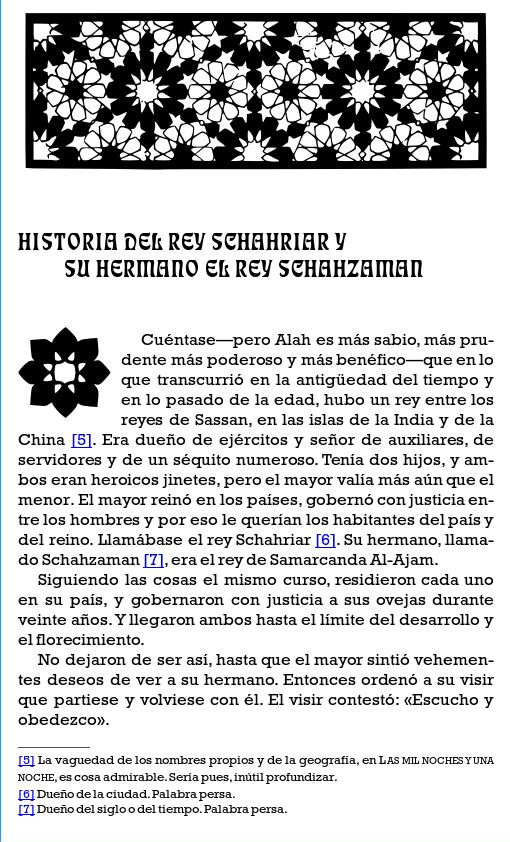

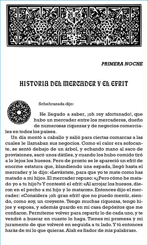

Old 10-06-2024, 06:52 PM   #44
RbnJrg
Posts: 1,933
Karma: 9600001
Join Date: Mar 2013
Device: Kindle 4 NT
Lol
Then it must give you a stomach ache every time you see layouts like the following:
ID:	211250Click image for larger version
ID:	211251Click image for larger version
ID:	211252Click image for larger version
ID:	211253Click image for larger version
ID:	211254Click image for larger version
The screenshots are from my epub2 version of "The Thousand Night and a Night" (in spanish) under KOReader. Under epub3 looks practically the same, but the footnotes are showed in a popup window (on an epub3 ereaders devices/apps).
Rejecting decorations in an e-book "a priori" and without further reason is prejudice on your part.
