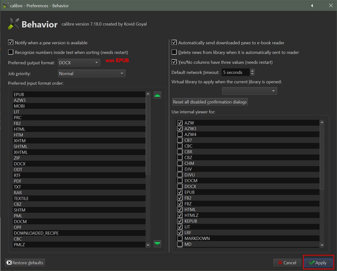

Works on Windows:
Name:	Screenshot 2024-09-22 081958.jpg
So it's either a MacOS 'thing', which I doubt, or you're looking in the wrong place… "input/output window under preferences", which window is that ?

You need to look under PREFERENCES->BEHAVIOR not PREFERENCES->INPUT/OUTPUT

You have been told twice by Kovid Goyal, the creator of calibre, and once by me that the Preferred output format: setting is in Preferences->Interface->Behavior… and this is its tool tip:
The default output format for e-book conversions.
When auto-converting to send to a device this can be overridden by individual device preferences. These can be changed by right clicking the device icon in calibre and choosing "Configure".
