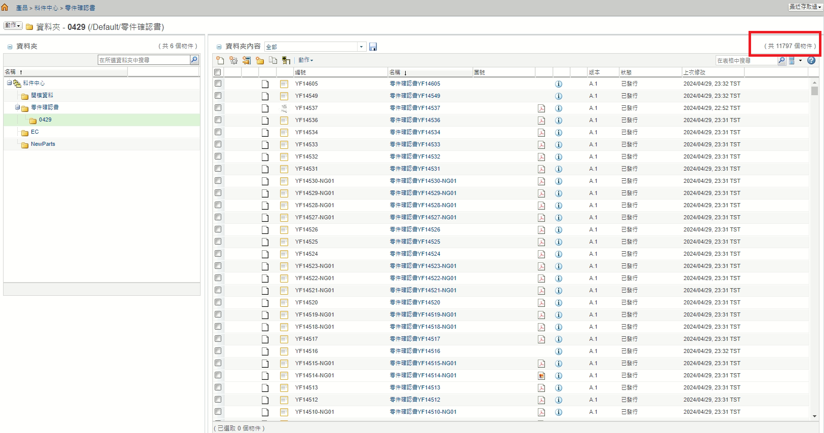

Name:	螢幕擷取畫面 2024-04-30 074904.png
Name:	螢幕擷取畫面 2024-09-18 135548.png
Is this edl mode?
aaron42195 is offline   Reply With Quote
