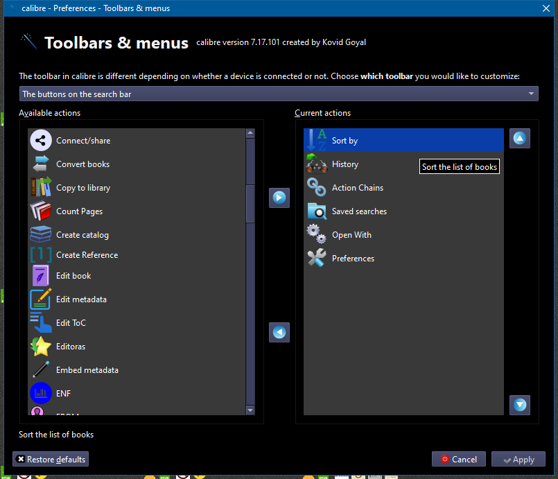

Well, if you want to add the Sort by button to the right side of the search bar, you want to do the following.
Enter Preferences (I think default shortcut is Ctrl + P) then -> Toolbars & menus, then select on the dropdown "The buttons on the search bar", find the Sort by item on the left panel and click the right arrow button in the middle of the dialog to move it to the current actions, see:
Name:	MWSnap 2024-09-09, 17_29_43.png
ID:	210715   Click image for larger version
Name:	MWSnap 2024-09-09, 17_38_13.png
That worked. Thanks!
