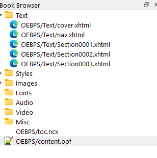

KoboUtilities will upload the cover image and flag it in the database bypassing reading the information from the ePub file. What I was looking for was in the content.opf (actually filename.opf but content is popular):
<item id="cover" href="Images/cover.jpeg" media-type="image/jpeg" properties="cover-image"/>
See the image for the text file bits.
