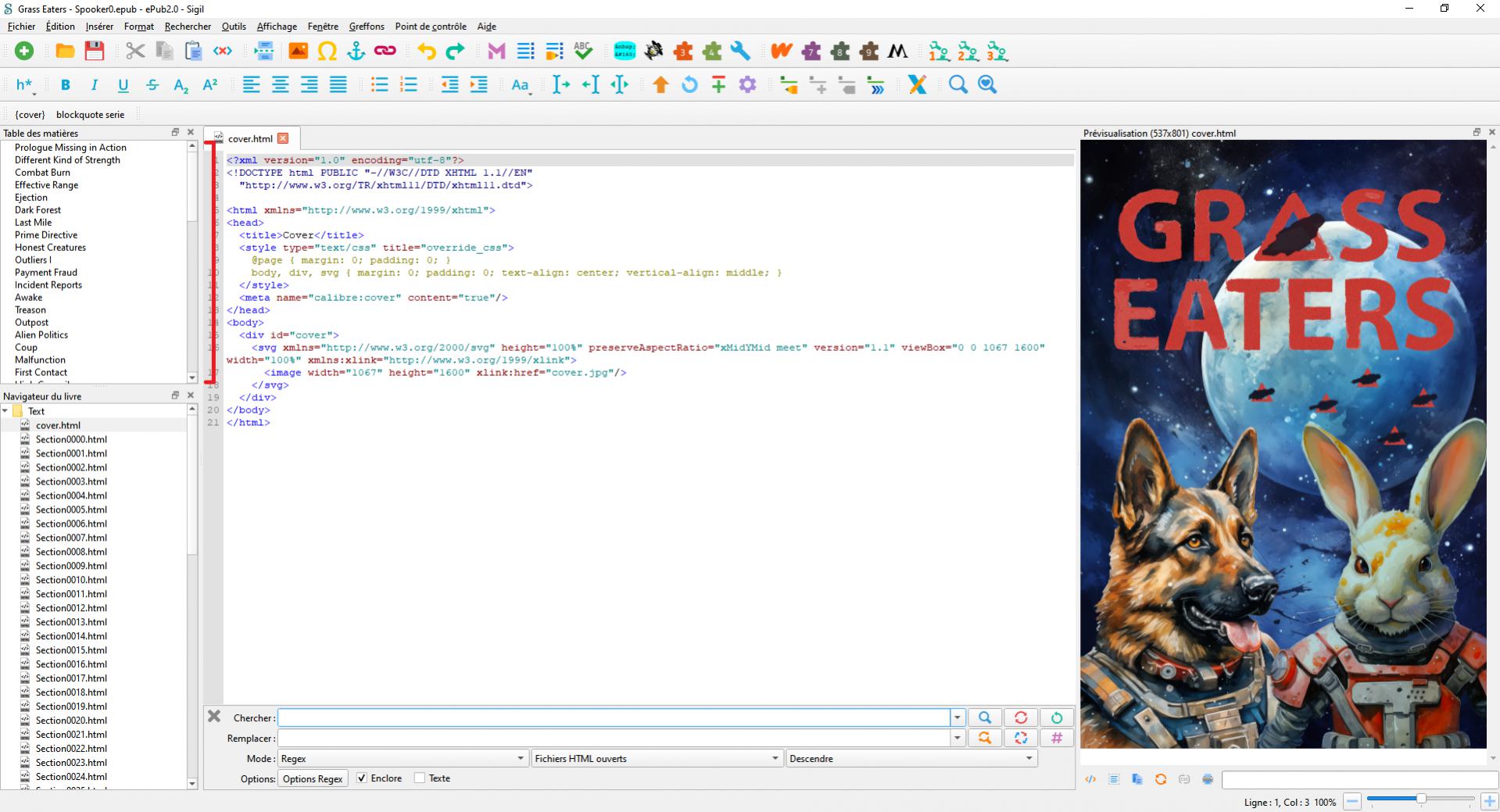

Little bug report:
The top-left window is gradually reduced at each open/close cycle (1 pixel).
This bug appeared when switching to the Qt theme.
Windows, version 2.3.0

From your Screenshot, it looks as if you have the Table of Contents on top of BookBrowser. And that the issue is that the Table Of Contents Window is shrinking?
Is that correct? How exactly are you "opening and closing" it? Is it with the View menu, or drag and drop or ...? What exactly do you mean by "switching to Qt theme"? Are you refering to dark mode theme?
The QDockwidgets do not remember their own sizes, their sizes are stored only when closing Sigil itself and restored on opening Sigil itself. Otherwize hiding and showing QDockwidget windows negotiates their own sizes.

Okay, I just tested this on macOS, and with the Table of Contents on top and BookBrowser open underneath both docked on the left (as your screencap shows), I am able to hide and view the Table of Contents repeatedly and nothing moves or shrinks. But this is with MacOS.

Until we find out exactly what steps are being taken, I can verify that on Windows (using either dark theme [or light theme]), the ToC widget (placed upper left, above Book Browser) is not shrinking for me when:
opening/closing Sigil
minimizing/restoring Sigil
opening/hiding ToC with View menu

OK. The "one pixel" thing is not really accurate for me, but I can confirm that the ToC widget (when configured on top left above Book Browser) does continuously shrink when closing/reopening Sigil when Sigil IS MAXIMIZED. I don't often run programs maximized these days, so I didn't notice at first. It seems to only shrink so far and then stop (in my testing). But it's definitely not remembering its geometry when maximized and closing/opening sigil. The theme has no effect on this issue.

In general: stacked (not tabbed) dockwidgets are not remembering their heights when Sigil is maximized on Windows (until some sort of minimal height is achieved on the topmost widget). I've not attempted more than two stacked (not tabbed) widgets at this point.
It looks like they've gained a lot of ground on the historical qt geometry issues when apps are maximized, but there are still a few minor things not quite there yet.
We're not going back to the mess of spaghetti code we used to deal with maximized geometry saves/restores pre-2.3!

I just tried this on MacOS (using Maximized not Full Screen) with the Table of Contents on the top left above BookBrowser, and it behaves even worse than windows ... it forgets I even moved the Table Of Contents to the top left and returns it back to be tabbed with Preview.
This only happens if Sigil's MainWindow is Maximized. If it is even just one pixel smaller in dimension than Maximized, all works as expected.
So this is a Qt6 bug in saving or restoring state that happens only when Sigil is Maximized.
Not sure we can do anything about it but create a Qt bug report, which will be ignored most likely since it is something so minor.

Okay, at least on macOS there is a race between the restoreState (which happens on first show) and the restoreGeometry (which must happen first!) because the call to showMaximized or showFullScreen sometimes forced the MainWindow to be activated/shown before we even had a chance to read in the state to be restored.
I have just fixed this by moving the reading the state in earlier so it is ready to be restored before any race can happen.
This fixes the moved Table of Contents bug when Maximized on macOS.
I have high hopes this "fix" will also fix this off by 1 or more thing for Windows too.

Okay, you found it, sorry for not being as clear as I thought.
About "switching to Qt theme":
In version 2.1.0 (and earlier), Sigil used Windows 10's native rendering system, which gave the UI a very square and flate appearance, since 2.2.0 Sigil use the Qt's integrated rendering system that was round and with relief. Image for exemple.
It was unspecified in the changelog and surprising, but unimportant.
So, the appearance of almost every element has changed (Tab, Text field, checkbox...) in some subtle way. I didn't notice the shrinking bug until just now, and given the significant change in the "switching to Qt theme" occured on 2.2.0, I assumed that this was the cause and that I hadn't noticed the problem until later.
And after testing, no, my bad again. The shrinking bug is specific to 2.3.0
