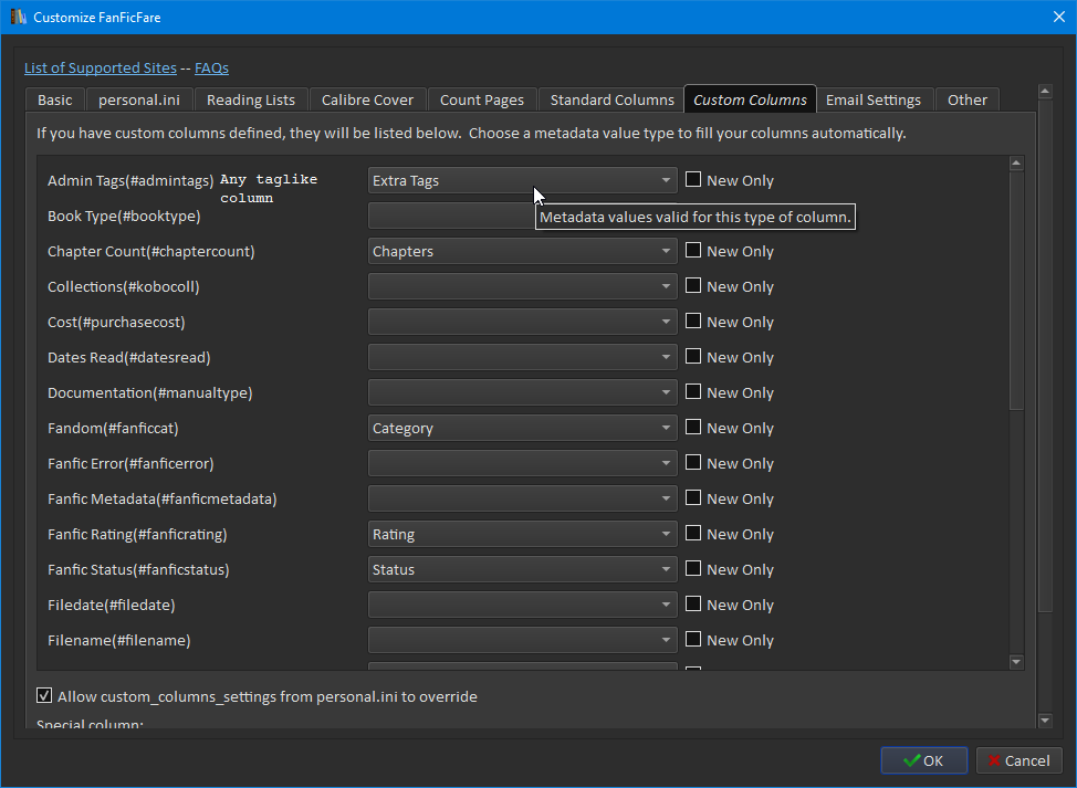

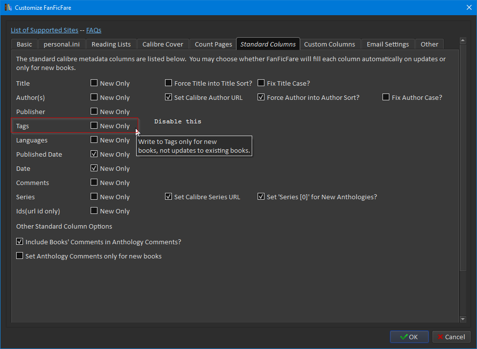

Are these set? It's been a while since I set this up so I might be misremembering.
That's exactly how I set it up, but I get nothing in the intended column...
Edit: GOT IT! I was trying to make sure that it worked with another 'tag like' data, but turn out that my tags were in the 'genre' data.
Why? I have no idea, but it works as intended now, so I'm not asking to many questions xD
