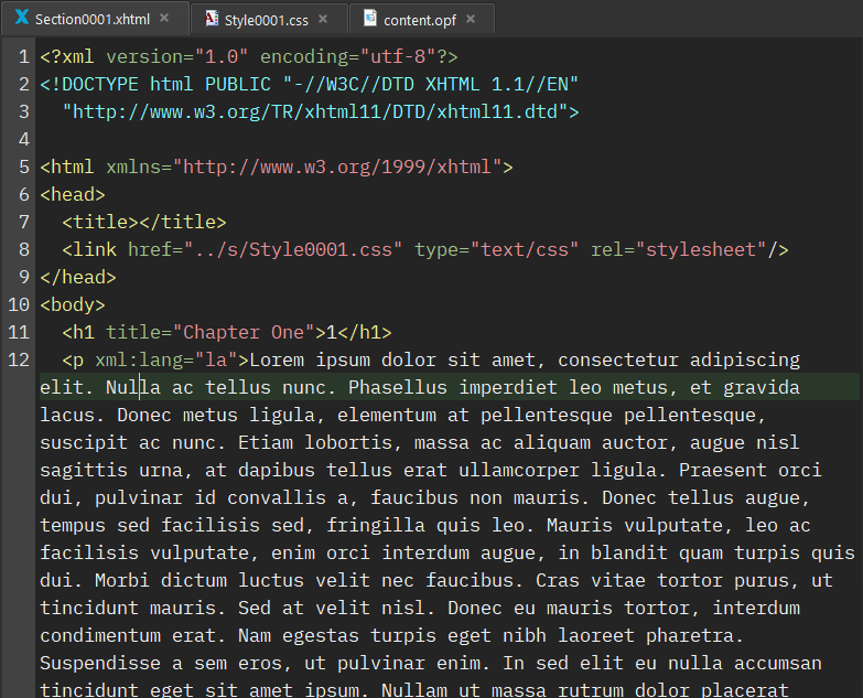

This cannot be done through a qss file.
Line height is sewn inside the font and depends on the size of the font offset.
I don't know if I'm using the right vocabulary, but it's simply a font metric that stores the height for the entire font and font family to maintain consistency.
In this exceptional case, for use in Sigil's Code View and without changing the program code (which is unnecessary, by the way) I think the best solution would be to edit the font and, for example, add 100 points ascender and 100 points descender.
An example below using the IBM Plex Mono font as an example.
One screenshot shows the original font and the other the modified one.
As you can see, in Sigil itself there is no control over this parameter of the Code View window.

But instead of editing fonts which can be tricky, perhaps we really should add a new Preference to Sigil CodeView preferences to set line spacing from single, 1.5, or double using QTextBlockFormat as DiapDealer suggested.

Yep, known bug in Qt going back literally decades:
https://bugreports.qt.io/browse/QTBUG-51891
So doing it programmatically is out! I really do not want to rewrite our highly customized CodeViewEditor class as a QTextEdit class.
This is so silly of Qt.
The only options would be to:
1. Use a font specially modified ala BeckyEbook
2. Use Zoom which helps text readability in general but not line height
3. Use Mend and Prettify to double space text in CodeView then use Zoom to make things cleaner
I am leaning toward BeckyEbook's idea. Perhaps we can modify a set of fixed width fonts (Courier, et al ) and use FontForge to manually adjust the font metrics for 1.5 and double spacing and include them as optional fonts alongside Sigil.
