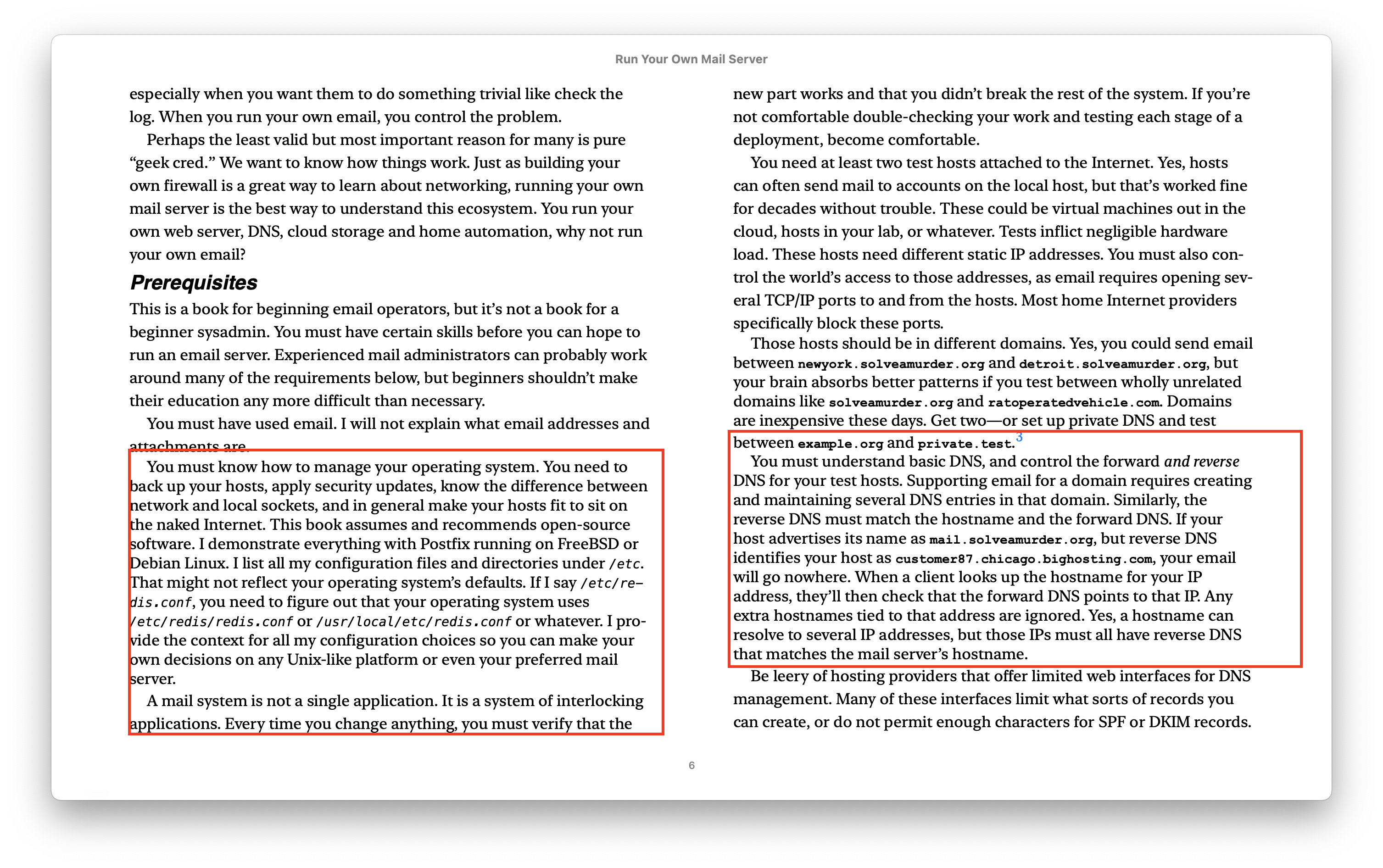

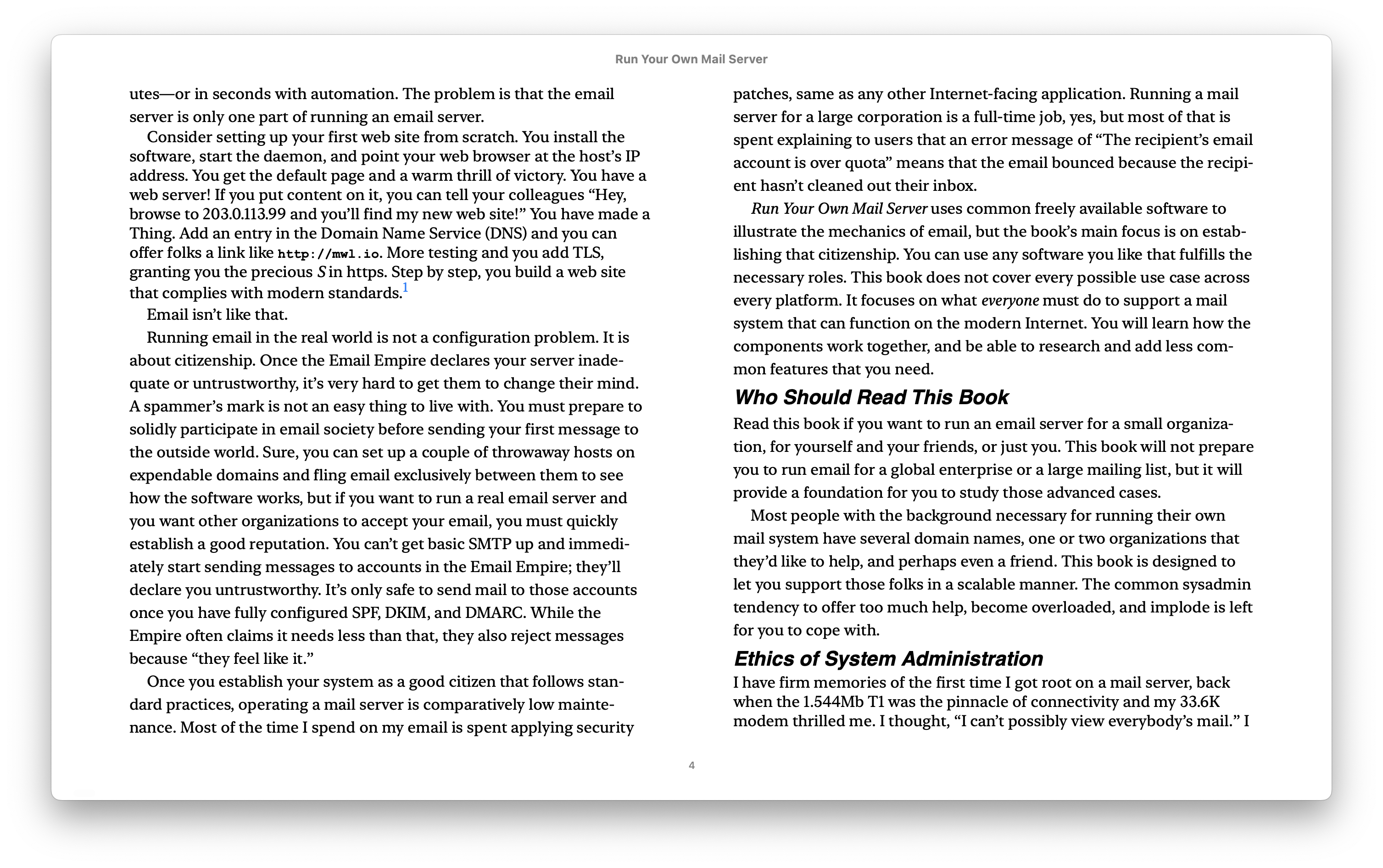

Hi,
I'm using Calibre 7.16.0 to convert my docx manuscripts to epub. The resulting epub works wonderfully in calibre, Kindle, and Adobe Digital Editions, but the spacing keeps changing in Apple's epub reader. I *think* I've attached everything, but just in case there's screenshots at:
https://cdn.mwl.io/junk/apple/bad1.png
https://cdn.mwl.io/junk/apple/bad2.png
A docx that reproduces the problem:
https://cdn.mwl.io/junk/apple/ryoms-appledebug.docx
A conversion of this sample:
https://cdn.mwl.io/junk/apple/ryoms-appledebug.epub
The conversion log:
https://cdn.mwl.io/junk/apple/convertlog.txt .
Is there some Apple-specific setting I should be using? Something in my docx style sheet that Apple's choking on?
Realistically: as conversion problems go, it's not horrid. It's definitely readable, just annoying for my readers. Any suggestions would be appreciated!

I was noticing a couple of items in your stylesheet. You are using a mix of absolute (px, pt, etc.) and relative (%, em, etc.) measurements. I would suggest sticking to relative other than for thin borders.
Also:
Several <span class="????"></span> scattered through the text.
You might try changing the vertical-align: super; to vertical-align: top;
There is a mix of line heights for text. 1.2 seems to be the commonest. I would suggest removing the line-height: 1.2; lines and letting the reader set their preferred line height with the line-height 1.5 being relative to that user set value.
Several mixes of text-align: center and non-zero text indents in the stylesheet.
Courier New is used as the monospace font in two places and Lucida Sans Typewriter in a third.
Also note that unless you embed any specified fonts, the reader will use replacement fonts for ones that are not available.
Someone who more enthused about Word and styles will likely chime in about the issues with the .docx file.

I looked at your sample DOCX with Word, the one thing I noticed was that the paragraphs with 'tight' line spacing have styling within them — e.g.filename and Users and Hosts… which converts to something like <span class=text4>blah blah</span>.
Is that true for all the paragraphs that are badly formed on Apple.
