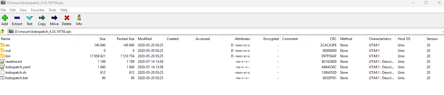

i have no idea what I'm doing wrong, but i have no out folder. so: downloading the firmware zip file, copying the zip file into src folder, enabling the patches I want, double clicking the bat file but nothing, no new koboroot. tgz file gets created. please, what am I doing wrong? thank you in advance for any ideas
Did you download the kobopatch_4.33.19759.zip from kobopatches-V84?
You unzipped that file into a folder on your local hard drive? That .zip file does have the out folder with a file called 'run_kobopatch_to_generate_these_files.txt' in it. See attached image.
I do agree that you should look at updating your Aura One to a newer firmware version.
