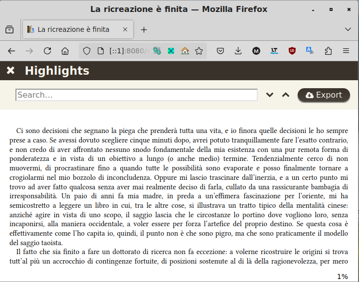

Calibre syncing highlights with notes between devices -- #2?
Although I have the server running and I have a user account "mel" and plenty of highlights in the text, the server still does not show the highlights. Please advise.
Name:	Screenshot from 2024-07-25 07-25-35.png
ID:	209817   Click image for larger version
Name:	Screenshot from 2024-07-28 17-26-54.png
ID:	209818   Click image for larger version
Name:	Screenshot from 2024-07-28 17-29-23.png

Make a new highlight, then open the book on the content server, access the viewer controls there, and click the sync button.

Yes, that works. Problem solved. Thanks very much.
