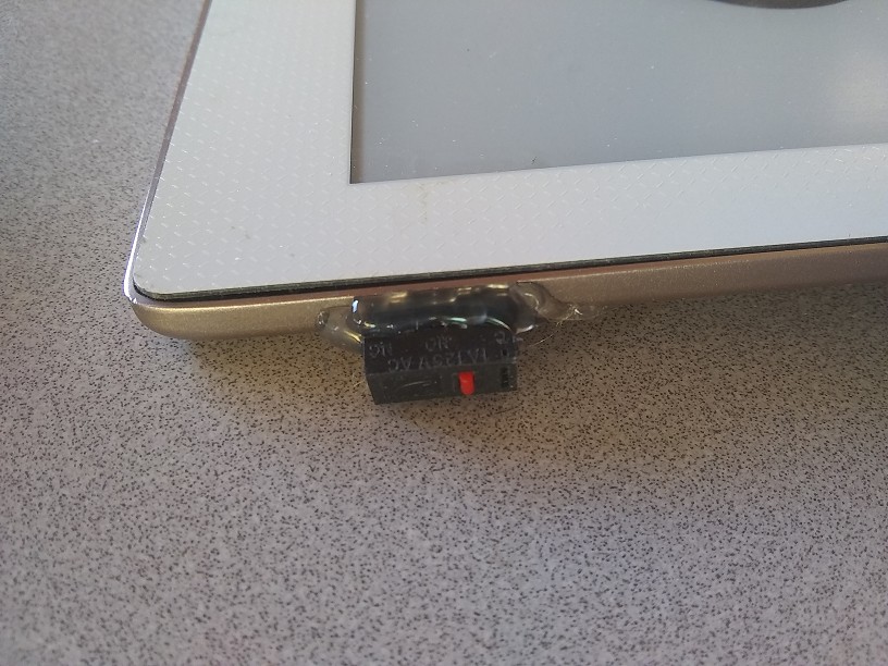

is the leaf/page repairable?
It depends what you did to it.
Repairability usually hinges first on ability to open the device in a non-destructive way.
Some devices use a lot of double-sided sticky tape.
If you have a supply and the willingness to clean up the original tape and install new tape, that's not a problem.
For many devices it's just a question of working a guitar pick around the edge.
Finding an exact battery replacement can be a problem.
In the past batteries were connected with standard pin/housing connectors.
Now they use teensy-tiny "mezzanine" connectors.
Those are those orange flex cables with a silver plate on top that snap in.
In worst case you can buy raw cells and reuse the BMS PCB, flex, mezzanine.
But don't do that unless you know what you're doing and are a good handworker.
Shorted Li-ion batteries can be dangerous.
Then there are button failures.
In worst case you can replace them with something that does the job but is not a physical match.

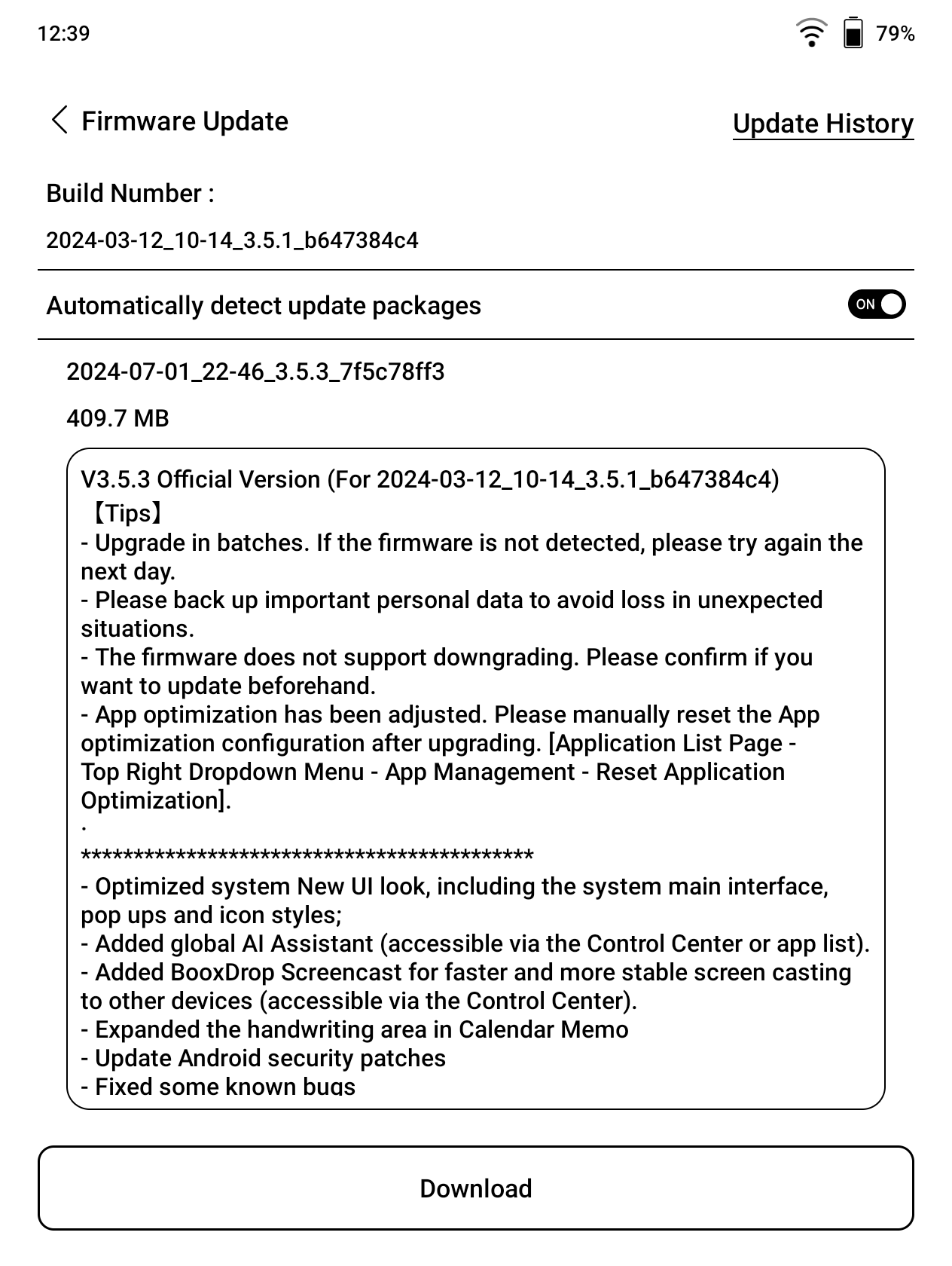

hi,
I can't get a link to the full update.upx for the last update (the one from 2024-07-01)
the usual http://data.onyx-international.cn/api/firmware/update?where={%22buildNumber%22:0,%22buildType%22: %22user%22,%22deviceMAC%22:%22%22,%22lang%22:%22en _US%22,%22model%22:%22Leaf2%22,%22submodel%22:%22% 22,%22fingerprint%22:%22%22} point to the previous update (2024-03-12_10-14_3.5.1_b647384c4) any idea how to get it?

Originally Posted by baruch View Post
hi,
You're right, I also received an OTA but the link downloads the previous version. the update installed without problems though. I backed up the .upx file if you want it?

Oh, you mean:
Model:  Leaf2 (English)
Finger: Onyx/Leaf2/Leaf2:11/2024-07-01_22-46_3.5.3_7f5c78ff3/8813:user/release-keys
Link:   http://firmware-us.boox.com/50570c969b16c994e2a4f3fc1f667837/update.upx
MD5:    50570c969b16c994e2a4f3fc1f667837
