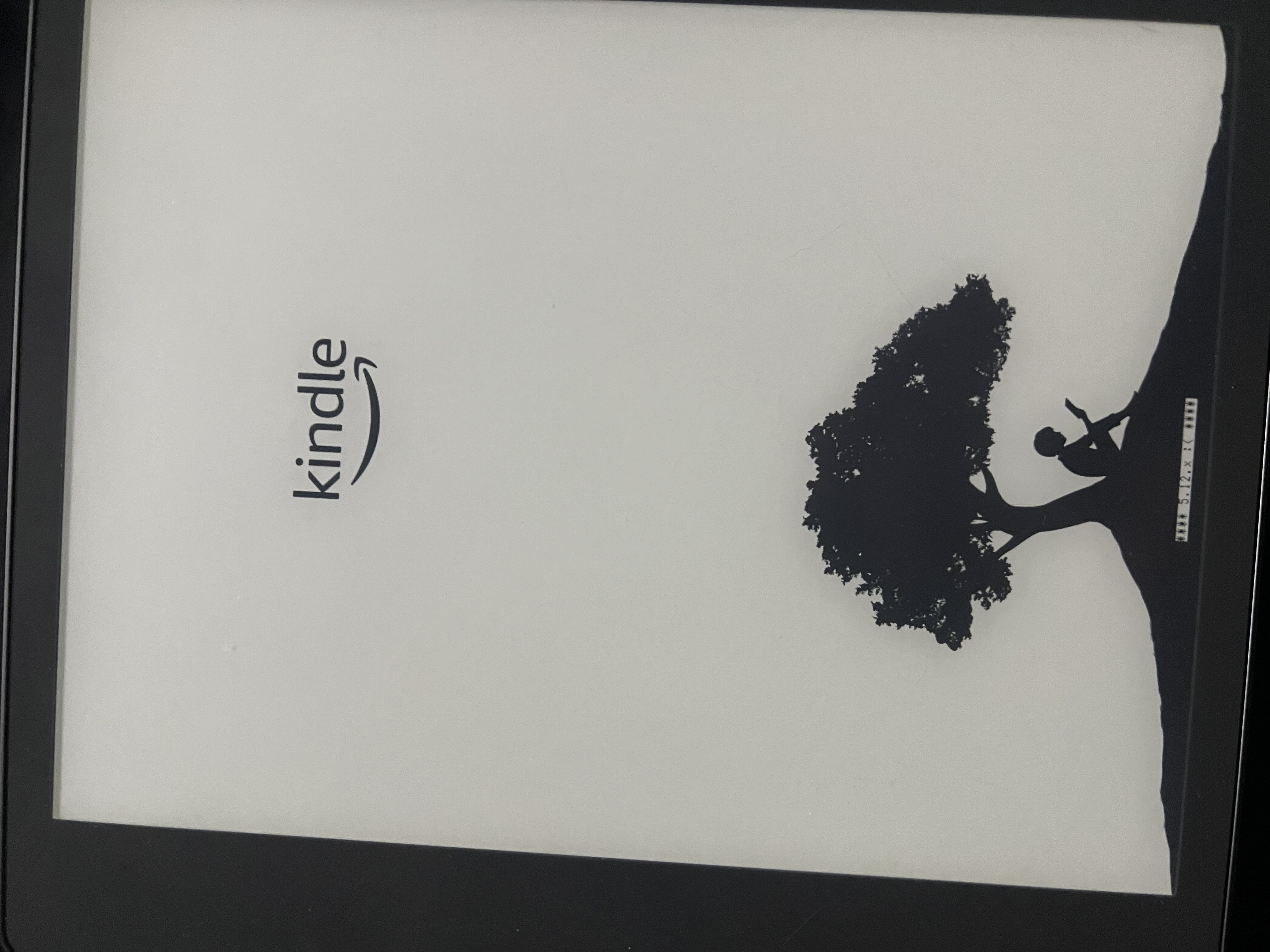

Originally Posted by nar001 View Post
I tried, I removed the file, it still stays stuck on the kindle screen. Just curious, what happens when you tap "restore" on a kindle? Maybe it added something since I was hoping it'd fix it before
Edit: Would there be any issues with doing the old "DO_FACTORY_RESTORE" trick? I don't wanna brick it even more, if possible

Edit: Weirdly enough reinstalling 5.16.2.0.1 twice didn't save it, still stuck at the Kindle screen, and doesn't seem to want to boot farther? It does let me mount it on my computer though, so not completely dead. It does still make coredump files, not sure if these would be interesting to try to fix it?
Edit again: Okay, so doing both a reinstall and a DO_FACTORY_RESTORE apparently fixed it. Not quite sure what's happening, but at least I have the language menu again!
Now I'm curious, is there any way to make sure things don't get as bad? I really don't think I did that much to blow it up like this, are Kindles that fragile? I wish there was a way to just reinstall, I've been using android tablets too long lol

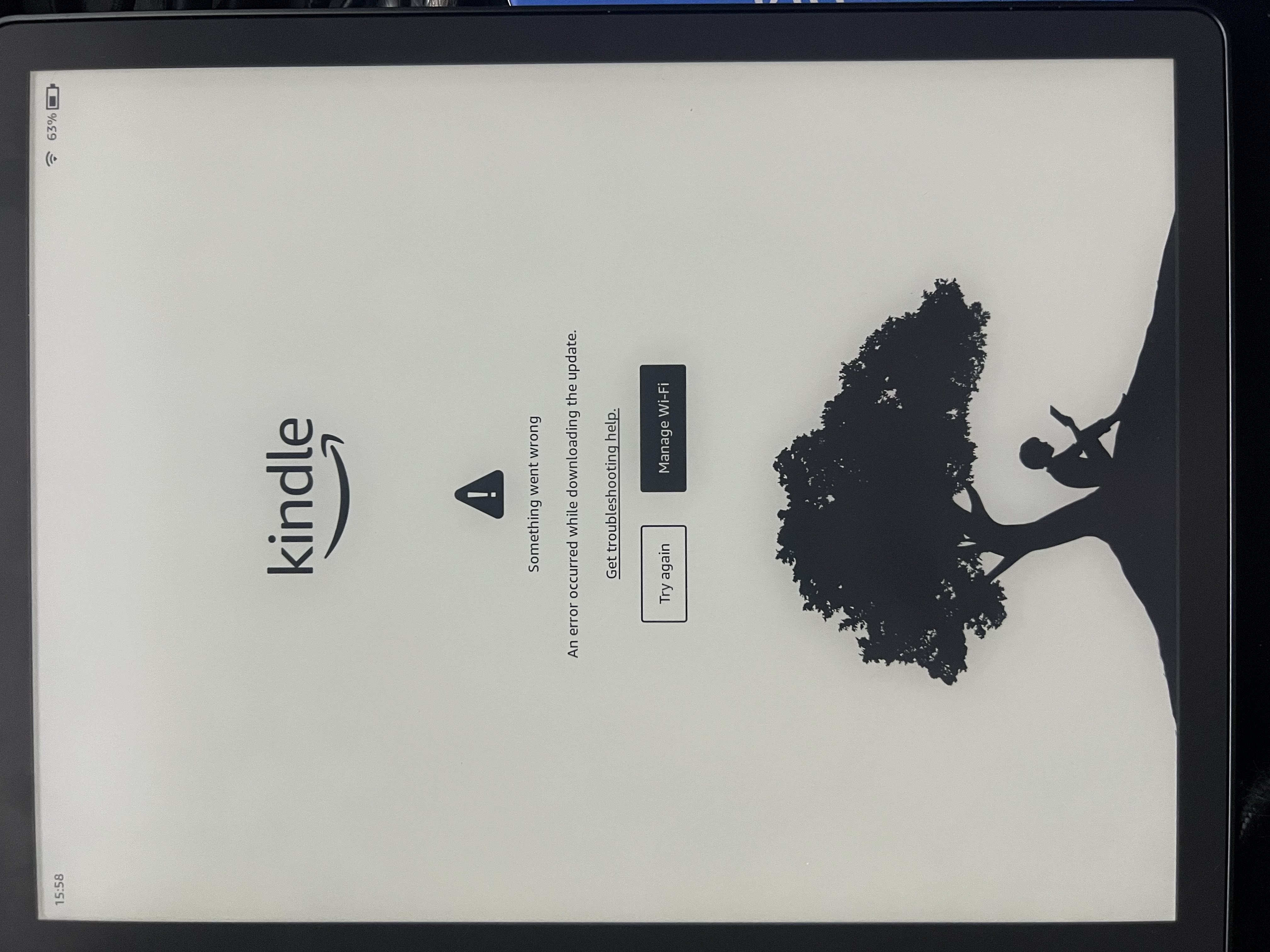

New question, I've been trying to use fakereg to "register" it locally but I always end up with this screen, and I'm not sure why, fakereg is from 2021, did Amazon change something about the registration since then?

Well wifi shows as enabled and the error message implies that it is trying to update.
Maybe some combination disabling wifi on your access point or disconnect incoming internet, and trying "try again" and "Manage wifi" enough times will get you out of it. And maybe some reboots.)
