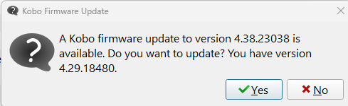

Karma: 182150337
A rather odd popup when I connected my Sage to calibre this morning. I checked the version file and it looks okay. A second connection and firmware check did not show the popup. A one off?
N778123456789,4.9.56,4.38.23038,4.9.56,4.9.56,00000000-0000-0000-0000-000000000383

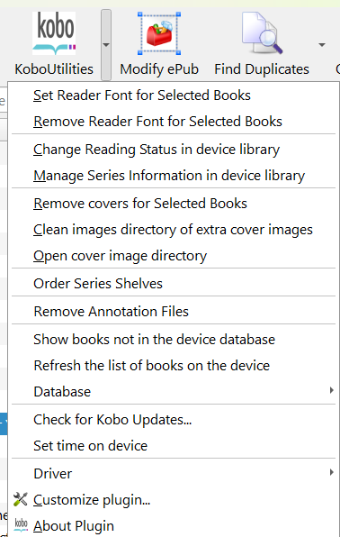

For those who might be interested, I've attached screenshots of the KoboUtilities base menu when no device, device present and library selected and device present and device selected.

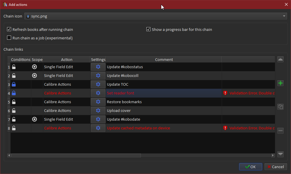

In my library, I use Reading List and a send-to-device list, which updates #kobostatus to identify those books as such.
After it's imported to the device database. I run an action chain on it for some regular setup (uploading covers, updating ToCs, pre-setting the font).
