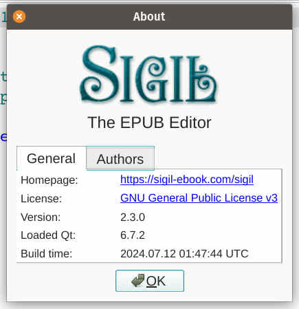

Excellent instructions, just like magic I'm running 2.3.0! Thank you DiapDealer!
I'll start exercising it tomorrow...

Wow! If I had known about aqtinstall and how easy it was to use to update your Linux distribution's older Qt to a newer version, we could have moved Sigil away from Qt5 to Qt6 much sooner and kept a tighter minimum Qt version requirement.
My rolling release Manjaro is stuck on Qt 6.7.1 and Jammy can now use Qt 6.7.2!
Very nice to have a clear set of instructions!

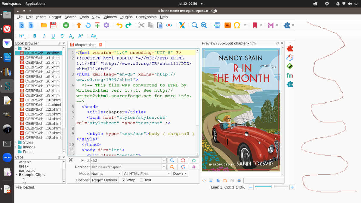

Sigil 2.3.0 on Linux
I spent a few hours today doing my usual tasks on a variety of books with the new build. Mostly, everything worked perfectly, but I found a few things:
I usually run Sigil maximised. When first opened, Sigil will open a maximised window, but an area to the right is blank. In other words, Sigil does not take up its full window. Clicking the maximise/resize window control twice fixes it. If I quit Sigil with a smaller window, it restarts in a smaller window and fills it; then maximising works fine.
PageEdit does not work, does not start. I expect I'll need a new version compiled against the Qt6.7 files. (I don't use it much, only to check a page view.)

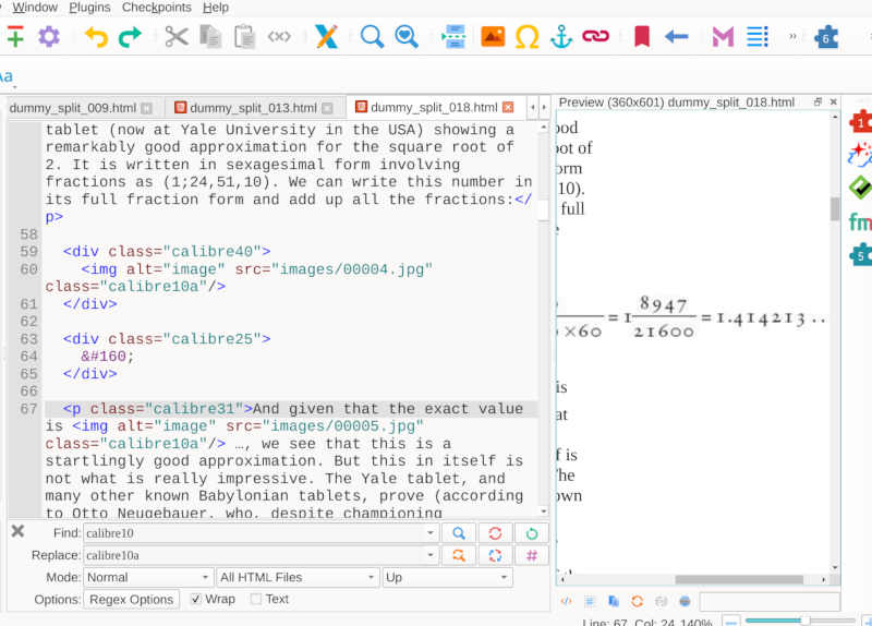

When a search causes a new file preview to be displayed, sometimes the text in the preview is scrunched over to the left. This happens when there is an image in that file that is not coded to stay in bounds -- some large image with no code to make it display properly. This comes and goes, it is hard to repeat exactly. I don't think I've ever seen it in older versions. In the same text file, once the text is pulled back with the bottom slider, scrolling up and down past the image does not cause this...only a search.
In general, the preview screen seems to flicker and flash quite a bit, I haven't noticed this in 2.2. Hard to describe; as you do other work like maybe remove a tag pair, it happens out of the corner of your eye. A subtle thing. Black vertical bars seem to flicker on the extreme right.

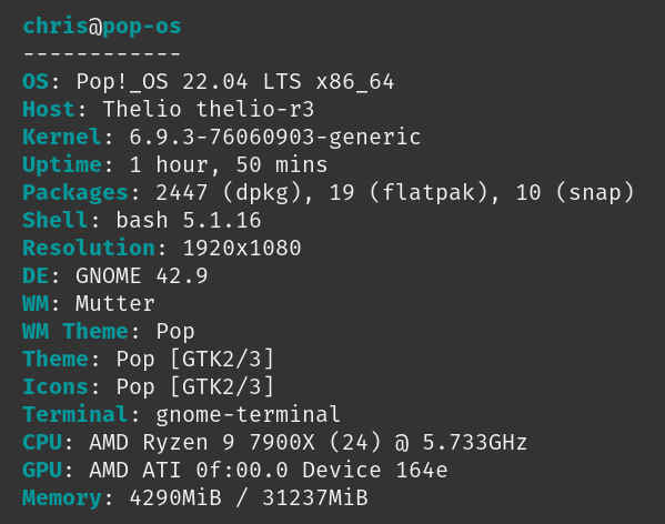

As I was installing the new Qt files, I saw some file with Wayland mentioned go by, So I booted up in Wayland to see how it worked (I normally don't use it). Well, everything looks subtly different but it all seems to work OK. The one thing that is really annoying is pop-up boxes (like to inset an ID) have no borders at all and are hard to see. But I doubt Wayland stuff will be a priority any time soon.
Pictures attached to show all the above, including my video settings.
If anything else comes up, I'll post it.

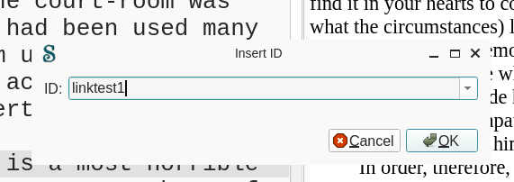

Yeah, Wayland's dialog and messagebox positioning is total nonsense.
I've not noticed any of the other issues you mentioned, but then I'm running Jammy in a virtual machine. Your issues sound a lot like a video card (or video card drivers) that Qt6.7 is close to leaving behind. You could try disabling WebEngine's hardware acceleration in Sigil's preferences. That may make those visual aberrations go away.
I never really thought about PageEdit, but rebuilding it against the same Qt6.7.2 should definitely fix it (when launching it via the external xhtml button in Sigil).

A few things:
- pop up dialog borders are set and controlled by your OS/Window Manager.
- search will try its best to centre the the highlighted found target in the centre of the screen. In your case the image pushed things right and forced the horizontal scroll bar into action. You can grow the Preview or detach it if needed, or Zoom it out so no scrolling is required. There has been no change to code in this area since 2.2 at all. Hopefully this is a one-off due to the lack of image formatting. If you can recreate a sample epub (single page) that shows the issue that would help.
- flashing should really be minimized in dark modes as Qt 6.7.2 includes a Qt official fix for the flashes during Preview update and load. Vertical bars on the right edge of the screen sounds like vertical scrollbar flckering in and out. I do not see this on macOS as the vertical scollbar is always there. This could be a Window Manager interaction. Maybe DiapDealer will be able to recreate it.
- Your previously compiled PageEdit with system Qt should continue to work, but recompiling PageEdit with the newer Qt to match Sigil is probably a good idea. My PageEdit is compiled with Qt 6.6.2 but my current Sigil is built with Qt 6.7.2 andit all works. But again that is macOS where each app embeds itsownQt version. All of my Linux boxes (1 real and 1 VM) only use the system Qt so I will give aqtinstall a shot to see what gives ...
- Not sure about the first start-up maximized issue. I do not see it on macOS but will try with my VM running Manjaro to see if I can recreate it.
Thanks!
Yep, I turned that off and all the flicker stuff goes away.
The funny start-up screen is still there.
