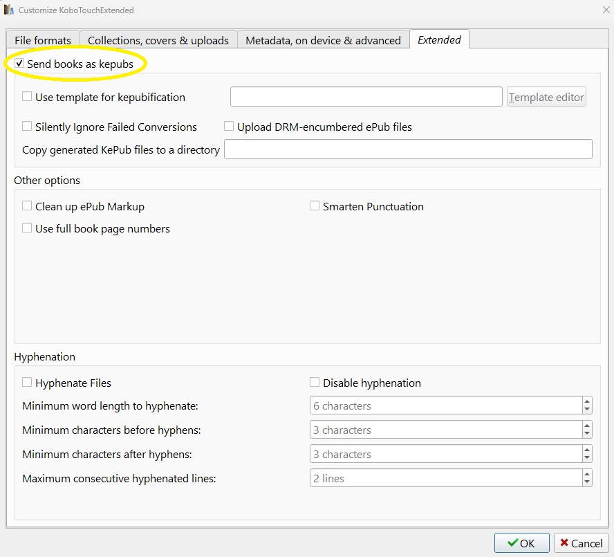

Originally Posted by denysm View Post
Books sideloaded onto the 2E after the update are shown as "KOBO EPUB", previous ones just "EPUB". The page counts for these newly loaded books is more than 3 times higher than they should be. The book I am reading now shows 870 pages; the same book on a non-updated Kobo shows 278 pages.
This sounds as if you have made a change in your setup so you are now sending kepub not ePub to your Clara 2E. That would explain the KOBO EPUB showing up as the book type. Since a kepub uses close to a page per screen whereas an ePub using the Adobe synthetic page number algorithm, the page numbers can vary wildly.
If you are using the Kobo Touch Extended driver, open it's configuration dialog and on the fourth tab (Extended), remove the check mark from the Send books as kepub. Alternatively, switch to the Kobo Touch driver (make sure you transfer the setup) which does not do the on the fly conversion.
Name:	Screenshot 2024-07-10 215736.jpg

What I was looking at was the "Books sideloaded onto the 2E after the update are shown as "KOBO EPUB", previous ones just "EPUB"." in the original post. This suggested a change in calibre settings to me. Possibly a switch from using the KoboTouch driver to using the KoboTouchExtended driver or a configuration change in the driver.

Thanks for all the valuable feedback. It was a setting in the Kobo Touch extended driver that needed changing. I'd had to do a Calibre re-install about the same time as the Kobo update, and hadn't looked to see if anything had changed in the plugin settings. In fact, I didn't even know that the culprit setting existed.
