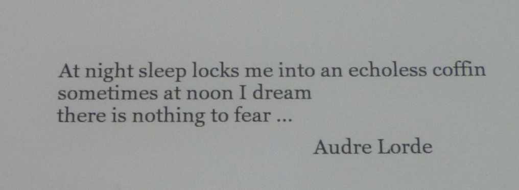

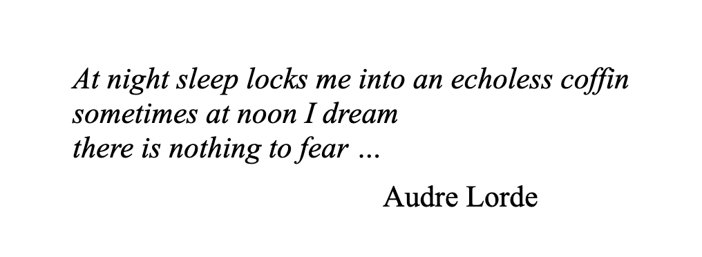

I realised it might be easier to discuss with some visual examples, so I took a few screenshots/photos, using 'The Gilda Stories' by Jewelle Gomez as an example.
In order: Calibre reader with the book open; Calibre ebook editor; Kobo Elipsa with the book open (Georgia font).
Name:	Calibre Reader.png
ID:	209465   Click image for larger version

Name:	Kobo Elipsa.png

I have tried Georgia, along with all the other preloaded fonts just to make sure. There's a photo of what the book looks like on my Kobo in Georgia font attached to post 8.
