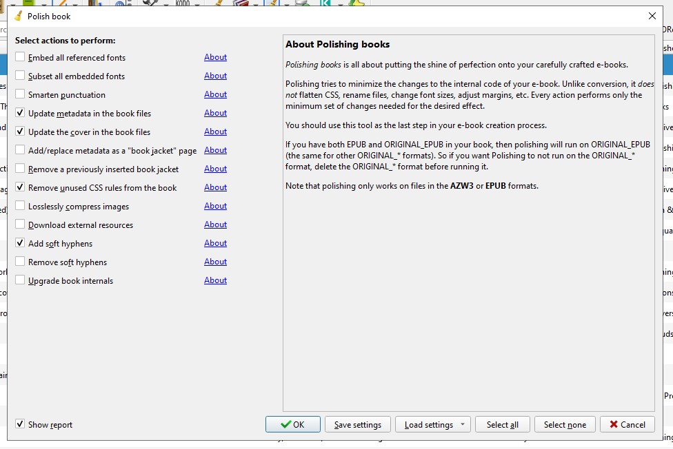

I wonder if someone can help. In Calibre I've added some new cover artwork to some books. I think my Kobo Color was connected when I did this. After disconnecting the new covers are not showing. How do I force it to update info from Calibre to the Kobo? Thanks!
Use the polish book on Calibre to embed the cover and metadata to your book before you sideload it to Kobo. You can add polish book on Calibre toolbar.

Using Polish or ModifyePub should not be necessary since the default is for calibre to update the cover and metadata in the file before sending it.
If you have KoboUtilities installed, you can use it's Upload Covers for Selected Books option to send the cover images to your Kobo without needing to resend the books.
The kobo generates the cover the first time it sees a book and then caches it.
Kobo utilities can update the cover in cache directly and then you don't need to resend the book. If you do resend the book, the cover in cache won't be updated by the kobo unless it sees it as a totally new book.
Yes, this - if you use 'do not treat replacements as new books' set in the driver, you need to use Utlities to update the cover. You also need to use Utilities option to update the table-of-contents if there's any changes to that.
Yes this exactly.
Also note that if you change the structure of the book, especially the TOC, and don't fix it with this option on, the book won't page correctly either.
But most other minor changes don't cause problems, so it's typically not necessary to treat replacements as new books if you take care of the above two issues. I think your highlights and bookmarks won't get disturbed this way, although if you add major new content you may find their location drifts from the correct location.
