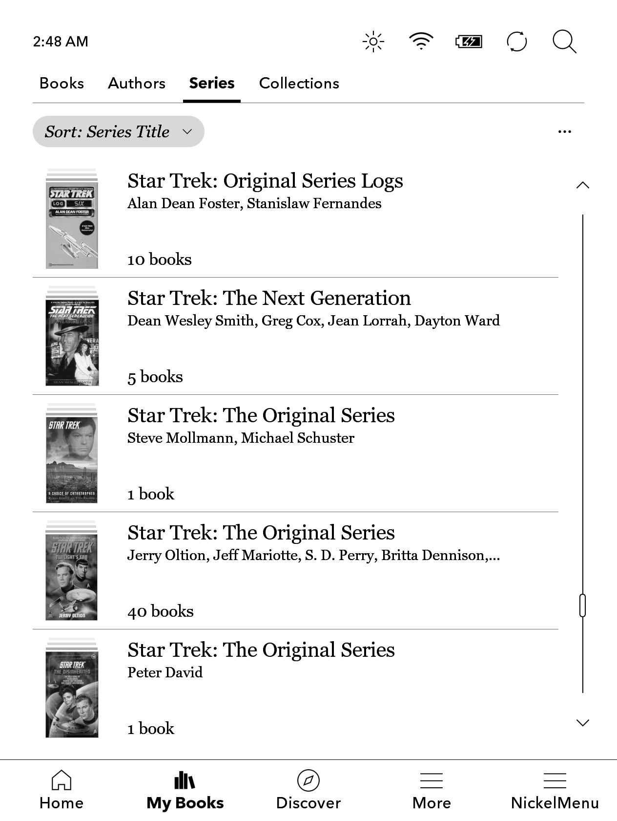

EDIT: Two recent acquisitions give an opportunity to demonstrate the accursed Pocket Books issue - 40 books I already set to the same SeriesID with the SQLite query, so they're a single series.
But the two other books, which I haven't merged in yet, have it set to different values (GUIDs provided by the Kobo store). So they show up as two separate series of 1 book each, even with the same name.
