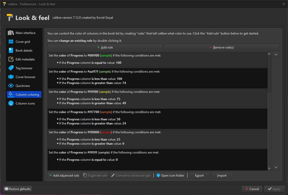

hi, I'm having trouble with coloring my "reading progress" column, it glitches.
and if somebody have an alternative way to do it, i would appreciate the help
Name:	Captura de pantalla 2024-06-09 150041.png
