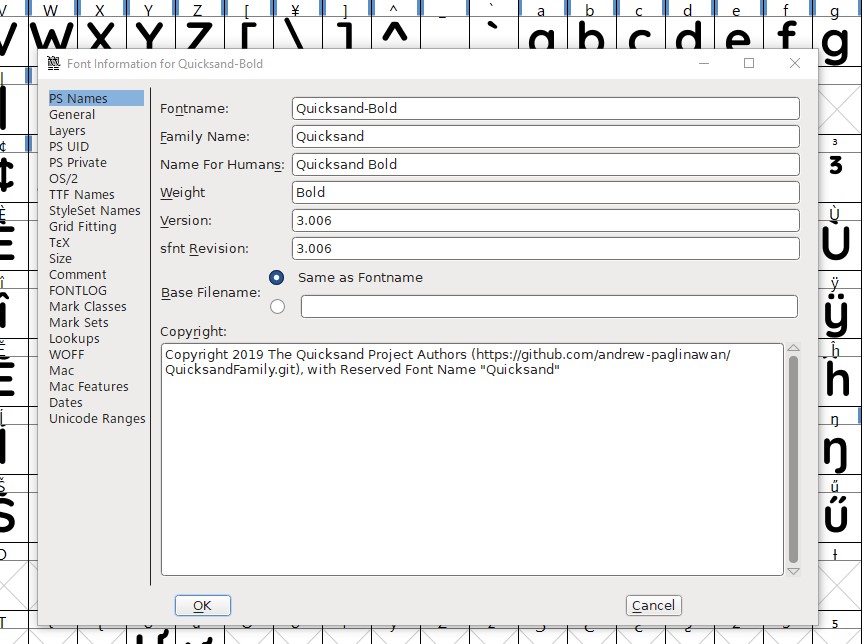

You could also install a font program, like Sourceforge and check what is specified in the font file.

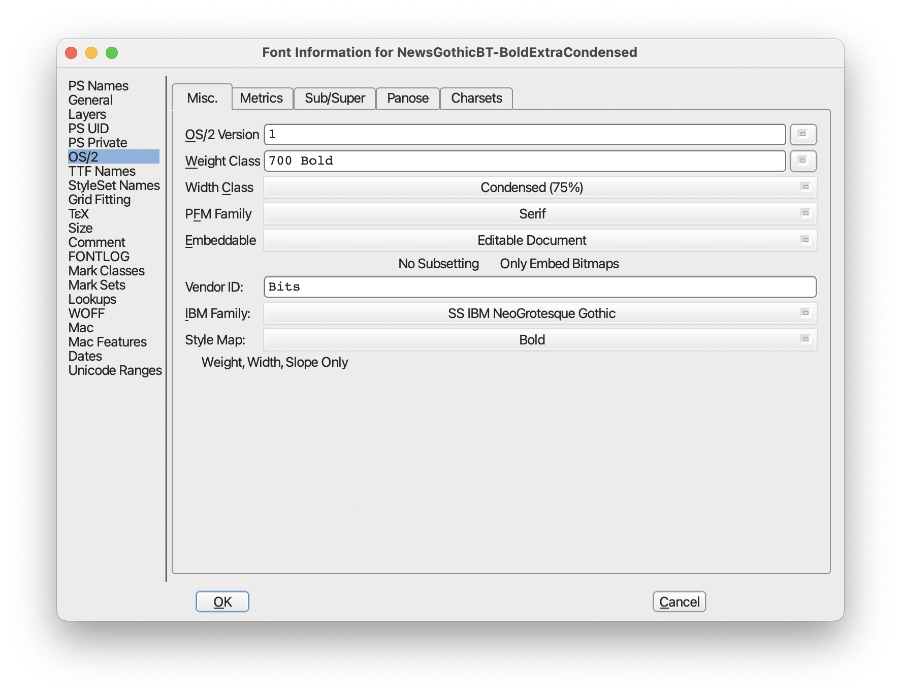

I've been using FontForge to check things with fonts in order to do things like get the font family name (because it was very wrong in the stylesheet originally for this font; it was listed as the font filename rather than the font family name). I've also been able to inspect other relevant properties with it, too (see the attachment for a screenshot).

Name:	Screenshot 2024-06-27 at 00.26.54.png
