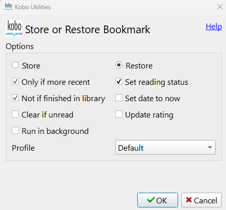

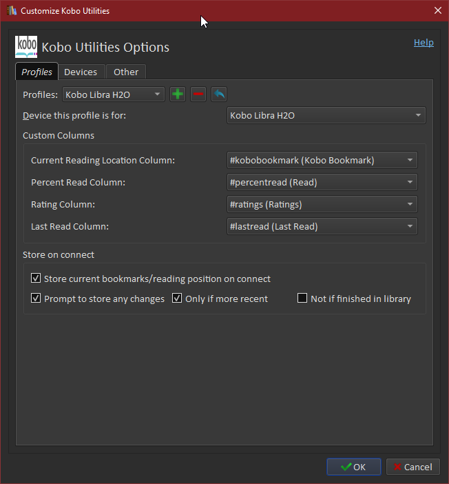

I'm not sure this is exactly what he refers to, but in the past I've used the last read column and 'store/restore current bookmark':
Name:	2024-07-06 18_40_59-Customize Kobo Utilities.png
I switch this to my custom #kobodate column, disable storing on connect, and then use 'store/restore current bookmarks' to put the date on device.
It only takes custom columns. You can use template search & replace (program: raw_field('timestamp')) to copy the Calibre dates to one.
Also note that after send, you need to disconnect and let Kobo import the books to its internal database before restoring bookmarks has effect.

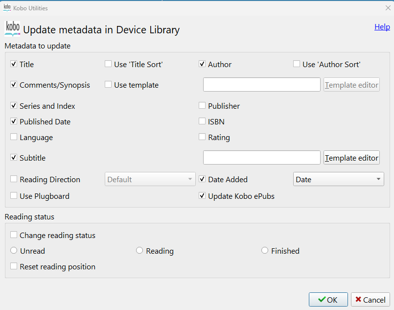

What I use when moving books to a new device are the Update Metadata in Device Library and the Store/Restore Bookmarks tools in Kobo Utilities. Updata Metadata using the Date as I have set it uses the date the book was added to calibre as the date added for your Kobo. The Store/Restore Bookmarks tool transfers reading status, finished, etc. to the new Kobo.

I made my Kobo Utilities Options look exactly like your screenshot, using the automatic column creation. I now have four columns, Kobo Last Read, Kobo % Read, Kobo Rating , and Kobo Reading Location.
What I *think* you're telling me is to create a custom column called #kobodate, populate it with the values in timestamp, and replace Kobo Last Read with the new kobodate column in Kobo Utility Options, and disabling store on connect in store/restore current bookmarks.
I found Preferences/Add New Columns and created an empty kobodate column. I also found Preferences/Template Functions, but am unclear how and where to include your code snippet. Can you point me to a howto?
The keys that weren't mentioned in your message are:
1) You have to eject the Kobo and wait for it to import the books.
2) After reconnecting the Kobo, YOU MUST SELECT THE BOOKS IN THE LIBRARY THAT YOU JUST UPLOADED before running "Update Metadata". Check that the number of updates made is what you expected.
The Store/Restore Bookmarks part isn't needed to solve my problem; I don't care about old reading status, etc.
Thanks, DNSB for showing the settings I needed for "Update Metadata".

Separate use of Kobo Utilities *IS* required
#2 is not needed.
What you want is to go to Preferences > Sending books to devices and under Metadata management, you want to set Automatic management. That will update the metadata automatically when you connect to your library via USB. You will not need to select anything and you won't need to send the metadata as that will be done automatically.
I already had "Automatic Management" selected, and it updates my categories ("Bookshelves" in Kobo parlance), as it has done for years. It did nothing for moving the Calibre date to "Last Read" in the database.
Using the "Update Metadata" in Kobo utilities is required in order to change the date "Last Read". It has to be after the books are transferred, and after Kobo does the database update -- before that happens, there is no record in the database for the new books for "Update Metadata" to adjust "Last Read".
Maybe this is a dumb question, but how do i get to these 2 dialogs?
I didn't find that, neither in Kobo Utilities' Configure Plugin nor Configure current Driver - KoboTouchExtended.

Karma: 83109135
Join Date: Oct 2018
It's in the Kobo Utilities menu when the device is connected.
