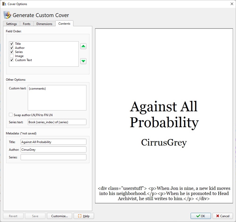

Using the novel's description as the book's cover?
I just finished getting all my fanfic onto Calibre, and I am trying to get the summary onto the cover of the books. I have the generate cover plugin and while I can have the summary on the cover, it has a lot of HTML with it. How can I make it, well, not have that?
I was trying to make a custom column for summary/comments that would edit those out, but I have no clue what I'm doing here.

Name:	stupid dumb cover art.jpg
Question moved to plugin's thread.

That comes from your custom setting: {comments} <you are seeing the raw, HTML .
That is not the best choice of something for a cover as they can be hundreds of words long. They are HTML because they can already be styled
And the Cover plugin expects to be the styler of simple text
