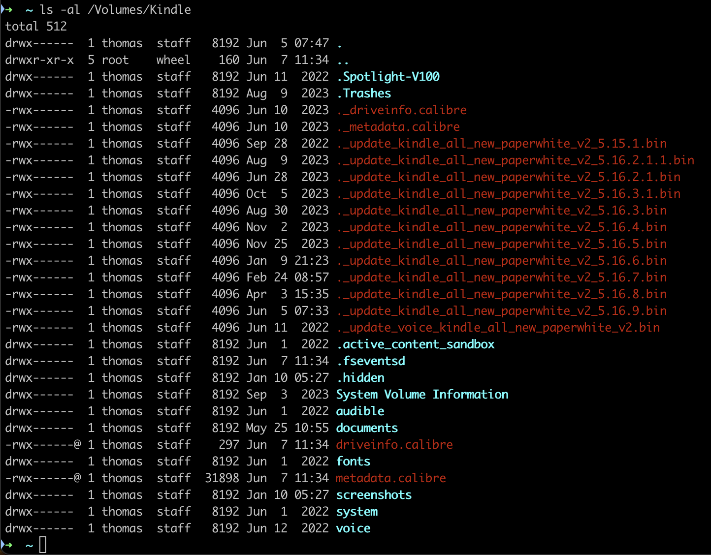

There's no easy way to detect if its necessary or not, so I prefer to err on the side of caution.
Updates leave 'breadcrumbs' unless they are explicitly deleted. So it is possible to tune behavior by looking for them. Maybe useful for some situations.

Posts: 53,363
Karma: 181495311
Those look like MacOS resource fork files so not likely to be created unless someone is using MacOS to access their Kindle.
That listing was from my Paperwhite, not Scribe.
My Scribe has the update breadcrumbs too, and it's not possible for macOS to create them, as it knows nothing about MTP.
There may be some question as to whether OTA updates leave them behind. But why wouldn't they? The update executes the same on device using Kindle OS, whether downloaded or side loaded.
Old 06-09-2024, 09:02 PM   #14
Posts: 53,363
Karma: 181495311
Why I was thinking of MacOS resource fork files is that my Paperwhite does not have them so I doubt that they are from the Kindle OS.
I just tested with 5.16.9 by copying the update file from a MacOS virtual machines. After the update, the update_kindle_all_new_paperwhite_v2_5.16.9.bin update file was not present but ._update_kindle_all_new_paperwhite_v2_5.16.9.bin was present and it was the only file of that type that was present. So I will have to say that if you are manually copying the firmware update files to your Kindle from a MacOS computer, those resource fork files will be left behind.

Finally I get it. Duh.
Well, one nice thing about MTP is that macOS can no longer leave these turds on Scribe. You cannot miss seeing them with an MTP browser.
