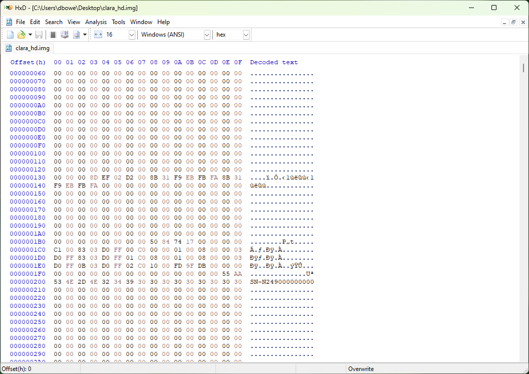

Hello, could you send me please the image for the Kobo N249 Clara HD (4.38.21908) ?
Do I need to customize the serial number or just preparing an sd card with the image should be enough?

You can just prepare an µSD card with the image which will give you a serial number of N249000000000. To modify that serial number, before copying the image to your new µSD card, use a hex editor to change the serial number at 0x200 into the image. The serial number is found multiple places in the image but the one at 0x200 seems to be the one that matters.

Thank you so much!
As I understand modifying the serial number is not required. Is there a reason for me to do that?

Originally Posted by Akobate View Post
Thank you so much!
Unless you are doing something that needs the serial number, not really. For me, it shows up as part of the filename when I use KoboUtilities automated database backup and is also required for downloading preview updates.
