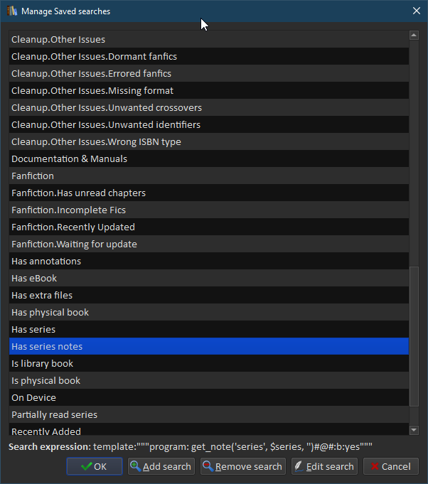

Issue: When editing a chain, opening the preferences for a new 'selection modifier' action causes Calibre to stop responding until I kill the process.
Running Calibre in debug mode doesn't show anything in the log after the "Hiding splash screen" of initial launch.
EDIT: It may be a result of my saved searches. If I switch to an alternate library with none, I get no freeze.
ANOTHER EDIT: I tested all my searches. All of them are valid, but as shown here, there's a lot of searches, including hierarchical and templates:
Name:	2024-05-29 19_15_50-Manage Saved searches.png

I am not able to replicate this. Is this related to the new test version?? Also does it happen with any Selection Modifier action? Does only happen with Selection Modifier actions that uses saved searches?

It happens with the current test version, yes. I didn't have any existing modifiers to test with, I was trying to create a new one but opening the settings triggered a freeze.
Very strange behaviour: I created an empty library that copied my existing structure, including saved searches. Everything worked here, creating a new modifier and then opening the settings again. When switching back to my main library, it also worked there.
But then when restarting Calibre, I get freezes until I switch to my test library and back.
Weird, but at least it provides a workaround.
