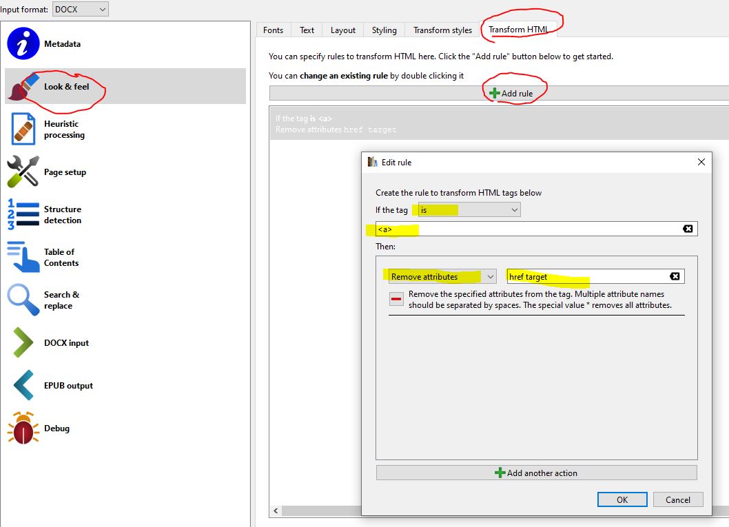

Unhappy How to strip all clickable hyperlink convert to epub
**I have no html knowledge at ALL
I know it have to do with:
When "Convert Books" > Look & Feel > Transform HTML TAB
then Add Rules:
but I just cannot get it right ( conversion error)
The Rules that have error is:
If the tag : is
<a>
Than:
Remove attributes: href target
***All I want to do is strip all clickable hyperlink function when convert to epub.

IMHO things like this is so easy in the Editor, that I gave up trying to do during conversion.
Diaps Toolbag (might be called Tag mechanic as it is also in Sigil) can delete or modify Tags with certain attributes.

You need
if the tag is "a" not "<a>"

You need
Thanks, that's all I need .
