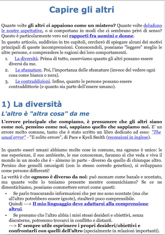

DOCX > EPUB Conversion - Change list indent
When I convert my Word (DOCX) documents into EPUBs, the lists (numbered or bullet) have an excessive indent (36 pt). See example below:
Name:	List indent A.jpg
I know how to manually edit the stylesheet.css in Calibre, to modify this indent.
But I wonder if there's a way to permanently set the lists' indent the way I want it (e.g. 6 pt).
- I checked the "Look and Feel" prefs in the Convert window, but it doesn't seem to have such option.
- Is there maybe a config or ini file in the Calibre software (either on Mac or Windows), that I can edit to set this indent?

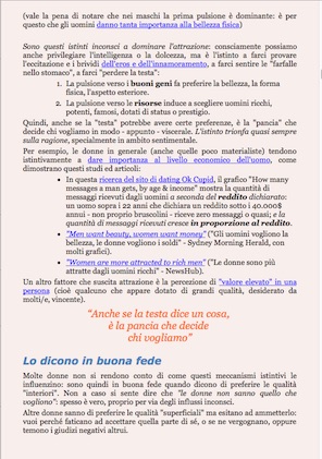

The problem: as you can see from the image below, in the EPUB both lists (numbered and dotted) have a much bigger indent than the original Word doc:
Name:	List indent CUT-XPORT.jpg
The following are the options I used during the conversion:
- DOCX Input: Do not try to autodetect... = ON
- EPUB Output: Do not split... = ON; No default cover = ON; No SVG cover = ON; Put inserted TOC... = ON
Hope this helps. Let me know if you need anything else for troubleshooting.
