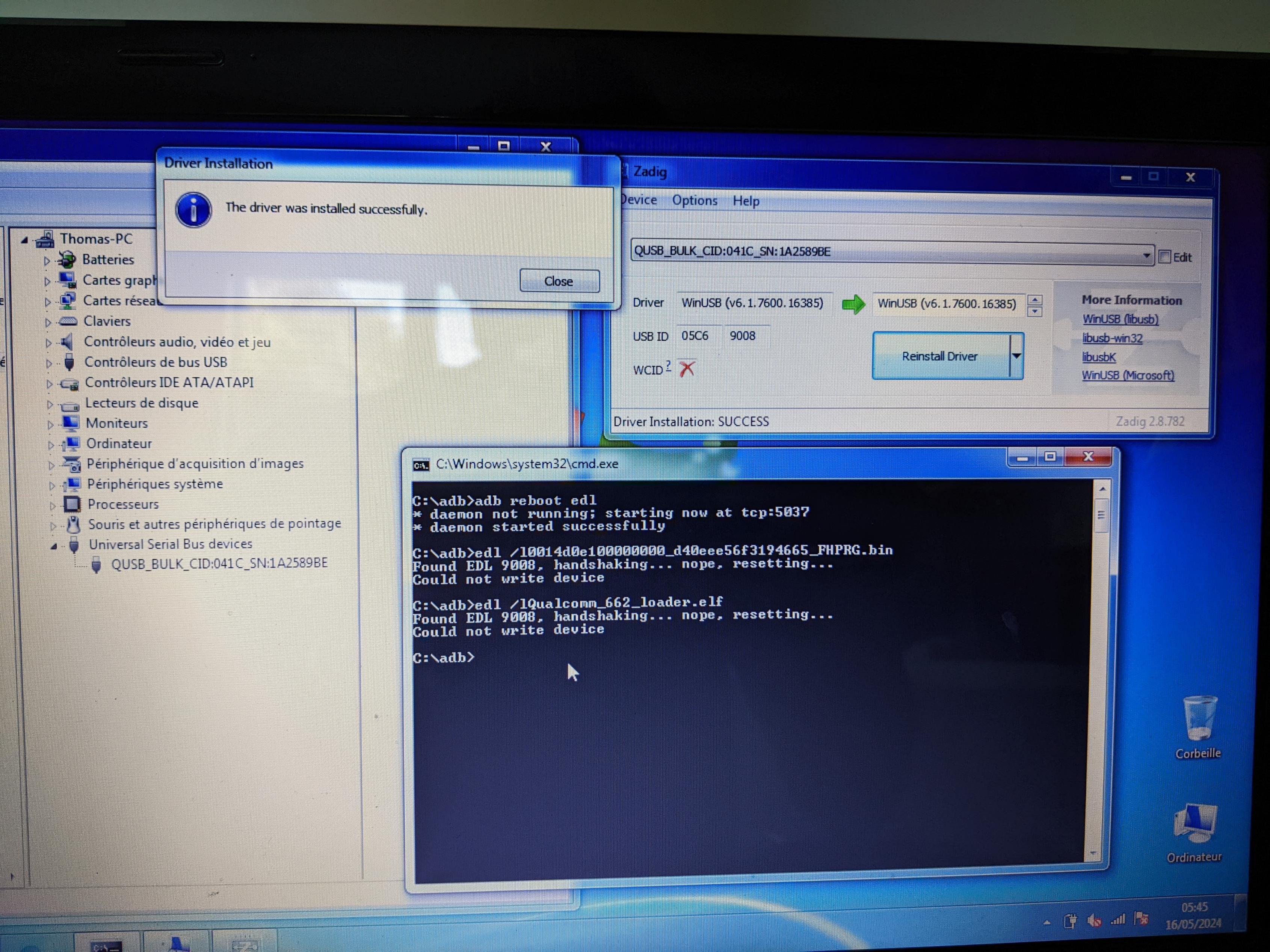

Thanks for looking at my thread.
So, I made another attempt this morning and was at least able to handshake my device.
I don't know what went wrong yesterday with the WinUSB driver. I am pretty sure I did install it correctly, but apparently not... I must have missed something.
That being said... Seems like I need to find the correct loader.
I indeed took this loader from your website yesterday (assuming that the page was a SN662 device, and of the same generation than the Tab Ultra/Tab Ultra C).
I also tried another one then. See attachment.
So now, I just need to find the correct loader, correct?
Note: Just to avoid drivers conflicts, etc... I just took my old W7 laptop for my attempts. I also have access to a W10 machine, and my daily driver (on which I usually do all my Android building stuff) running Archlinux.

While for entering edl mode, is there any other know method but adb (for Onyx devices)?
I tried the two fastboot commands, but they are not working.
No, you didn't. The conversation was all one-sided.
The Sahara protocol is very fragile. That means between entering EDL mode and using edl.exe you can't do anything. The Windows driver has to already be installed. You can't disconnect the USB cable at any time.
Reset the device and try again.

Ok, so. Assuming the USB driver is the correct one and now installed, I connect my device to my laptop and adb reboot into edl mode.
Keep it connected to my laptop, make sure it's the right driver and then launch edl.
Correct?
Is the USB driver installed the good one?

Why is it always saying "daemon not running"?
It should only say that once after you power up your desktop.
I thought that the Page is eMMC?
Don't say /u
Oh it's just because I rebooted my computer to see if it would help it working.
You're right for the emmc, I have misread the Onyx Wikipedia table.
I have just tried again after cleanly rebooting the device and with another USB cable and it works again.
I'll play a bit with it then.
