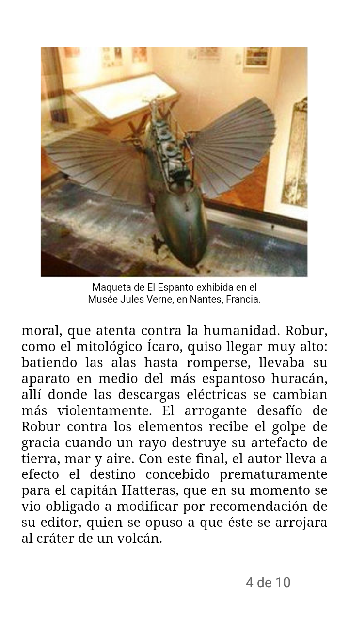

On epub3, the reading experience is very good, even in a small screen. Image and caption are a % of the height viewport (retaining proportions). And by tapping the image (in a good epub3 ereader) the same one will be showing at full screen.
Here you can watch screenshots from Kobo for Android on a 5" screen:

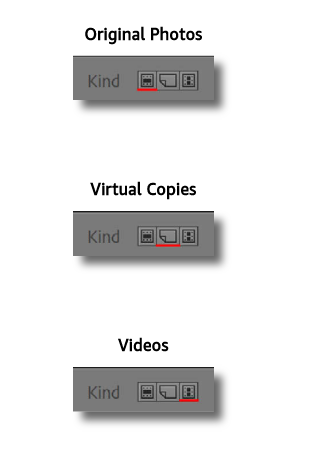

The only thing that I need now, is some help to decrease the gap between my images/figures - tried some options but not able to solve it.
See image attached

Do You want to reduce the vertical space between those three images? Ok, post here the code you are using and that are producing that output and I/we will try to help you. The fact you are working on epub3 wiil make things easier to fix them.

Phew! What a mess! Very ugly Indesign is not able to generate a decent code. Use the following:
a) In your .xhtml file:
  <figure class="wrapper">
    <figcaption class="caption ImageCaptionCentered Semi-Bold">Original Photos</figcaption>
    <div class="MainImage">
      <img alt="" src="image/84-4.jpg"/>
    </div>
  </figure>
    <figcaption class="caption ImageCaptionCentered Semi-Bold">Virtual Copies</figcaption>
      <img alt="" src="image/84-5.jpg"/>
    </div>
  </figure>
    <figcaption class="caption ImageCaptionCentered Semi-Bold">Videos</figcaption>
      <img alt="" src="image/84-6.jpg"/>
    </div>
  </figure>
b) In your .css stylesheet:
.wrapper {
  float: left;
  width: 100%;
  text-align: center;
  box-sizing: border-box;
  -webkit-column-break-inside: avoid !important;
  page-break-inside: avoid !important;
  margin: 1em 0 0; /* Here you control the gap between images; change 1em as you wish */
.caption {
  font-size: 1rem;
  font-style: italic;
.MainImage {
  width: 23.72%;
  border-style: solid;
  box-shadow: 14px 14px 10px rgba(0, 0, 0, 0.6);
  margin: 0 auto;
.MainImage img {
  width: 100%;
I still used styles "ImageCaptionCentered" and "Semi-Bold" but they are not defined in you .css. So, if they are not present in your stylesheet, you can delete them and instead of:
you can use:
<figcaption class="caption">
And now one last thing; the three images, must be joined? That is, a break can't be produced between them? Because the code is different is a break is allowed or not. The above code allows a break between the three images (what the above code makes is to maintain the caption joined with the images, but not the three images joined. For the latter, something more is needed.)
