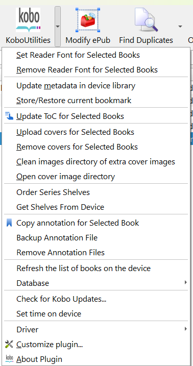

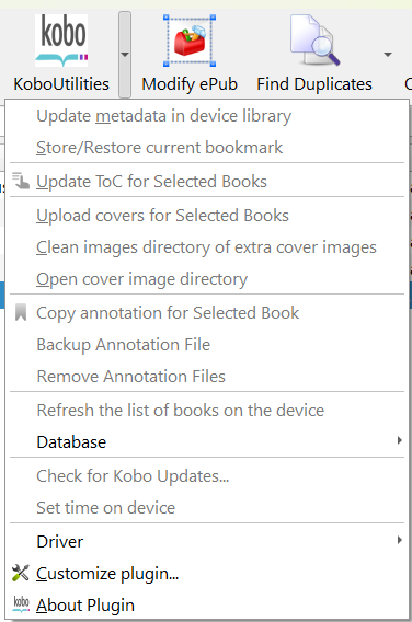

Hi, after installing the plugin in calibre 7, I can't see the option for changing metadata in the menu...
Any thing I did wrong?
Thanks.
rafakobofan is offline
Old 05-19-2024, 08:03 PM   #2924
Posts: 54,168
Karma: 182161593
Thanks.
Are you looking at the menu with a Kobo device attached? See the attached images for unconnected and connected. Though I'm not sure what you mean by changing metadata? Sending updated metadata, yes. Editing metadata? That's done in calibre main interface.
