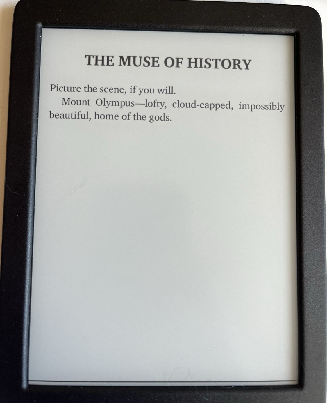

RMSDK is perfect. The purpose is to see if RMSDK in V5 has been updated.
Please try the attached ePub. It's nothing special at all. But if RMSDK was updated, you should see smallcaps in the first two lines. Please let us know what happens. Thanks.
Good morning!
Running fw 5 on tolino does not support the small caps
Opening the file with default was not successful, after 5 MINUTES of waiting I got impatient and did reset the unit.
With Rmsdk it took 5 SECONDS

Good morning!
Please take a look at those videos for any errors:
https://1drv.ms/f/s!AtyrllFIkEE7g_wWrvT6NsA2Are-Bg
It’s morning and my cat watched the process
Thank you. RMSDK has not been upgraded. That answers that question.

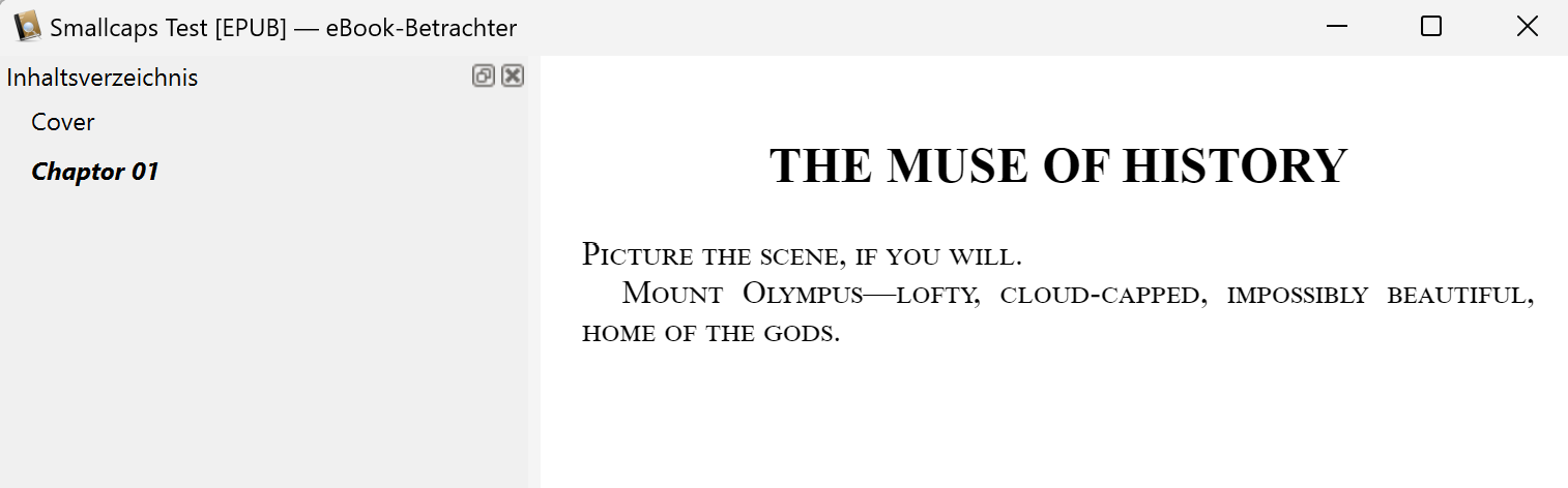

For what it's worth, Calibre does correctly show smallcaps
