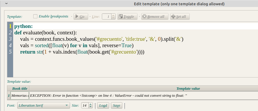

Old 05-11-2024, 09:37 PM   #664
dunhill
dunhill's Avatar
Posts: 1,212
Karma: 1512904
Join Date: Sep 2017
Device: moon+ reader, kindle paperwhite, Linux Mint
A template has stopped working.
I was using the formula from this thread https://www.mobileread.com/forums/sh...&postcount=574
python:
def evaluate(book, context):
	vals = context.funcs.book_values('#ranking', 'title:true', '&', 0).split('&')
	vals = sorted([float(v) for v in vals], reverse=True)
	return str(1 + vals.index(float(book.get('#ranking'))))
to calculate the ranking position and now it says that there is an error on line 4
Give me a hand with the solution

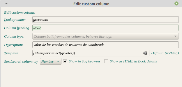

Old 05-11-2024, 10:13 PM   #666
dunhill
dunhill's Avatar
Posts: 1,212
Karma: 1512904
Join Date: Sep 2017
It would be helpful if you provided the actual error message.
Edit: an error will be thrown if #ranking contains something that isn't a number
I leave you screenshots
The personal column #grecuento
and the template

Old 05-12-2024, 01:57 AM   #667
chaley
Posts: 12,529
Karma: 8125420
Location: Notts, England
and the template
Again, the actual error message is needed.
Note that line 4 will fail of the composite template returns something that isn't a number, for example the empty string.

Old 05-12-2024, 01:23 PM   #669
dunhill
dunhill's Avatar
Posts: 1,212
Karma: 1512904
Join Date: Sep 2017
If we see the capture of grvotes ids it says 410
The real error is described in the first image:
Exception:Error in function <listcomp> on line 4: ValueError could not convert string to float: "
The strange thing is that it used to work fine.
I really don't know what happened but it was solved by redownloading or updating metadata, I was really worried. As always, I appreciate the help always received.

Old 05-12-2024, 02:03 PM   #670
chaley
Posts: 12,529
Karma: 8125420
Sorry that I didn't see the error. It says that the votes for the book was the empty string, which can't be converted to a float. Is an empty or missing grvotes id something that shouldn't happen? It seems to me that it will always happen for new books. Updating metadata would fix that. The template can be changed to detect a missing id and do something else.
And you are welcome.
