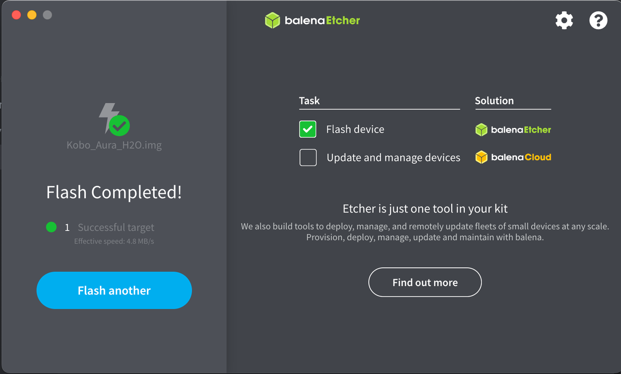

Old 05-08-2024, 09:02 PM   #13
obsessino104
obsessino104 began at the beginning.
Posts: 10
Join Date: May 2024
Device: Kobo Aura
I would recommend using Balena Etcher. Several MacOS and Linux users have reported success using it to write the .img file to an µSD card.
Thanks for the kind guidance.

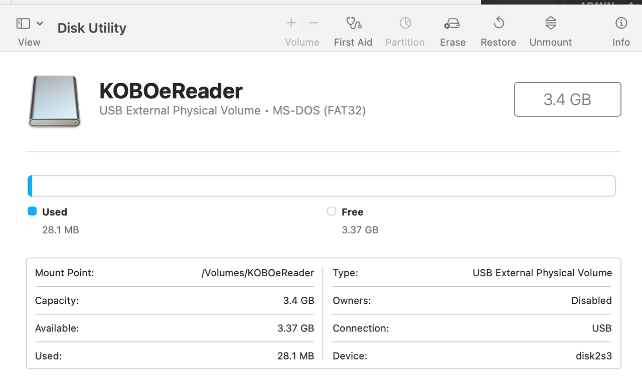

I used your suggested, it flashed the uSD card fine.
I read the uSD, its empty contents.
But in Disk utility, I can see 28.1MB of data in it.
Then I tried to place the flashed uSD card in the slot. Powered Off. Power On, five dots, blinking through the 5dots, Language setup screen.
Do I need to press any button combination to get it load the uSD?
